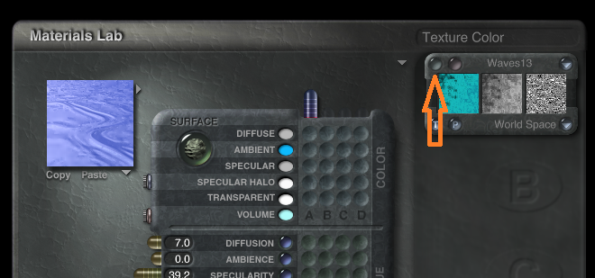

    Simple as it is, one of my biggest break-throughs when using presets that didn't look right from my camera-distance/angle was the Material Lab's 'frequency' adjustment.
    This was a Bryce show-changer for me! The presets kept *not working together* as I'd wanted them in my mind's eye, and this got me back on track!

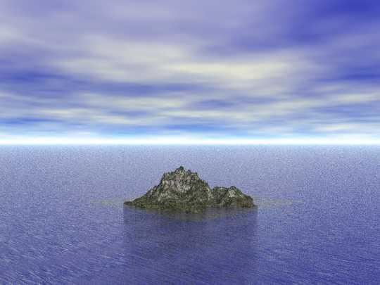

    Scenario - I open a scene, make a terrain, bury it half under the default infinite plane, apply a water material to the plane, and apply some vegitation to the terrain - wala! island scene - just like the pros!
    Except it wasn't... The water material (Clear Swirl) I'd picked with the default scene looked something like:
    Interesting, but not right...

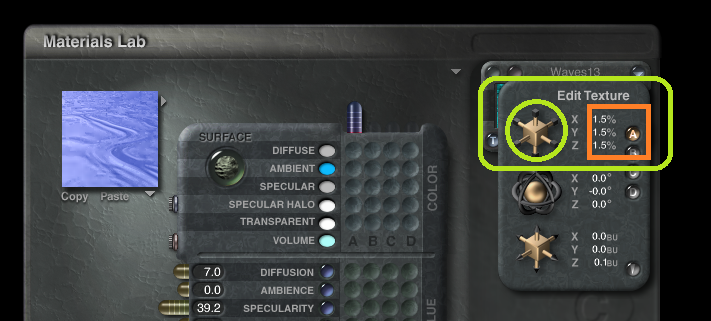

    Using the frequency setting found in the Material Lab:

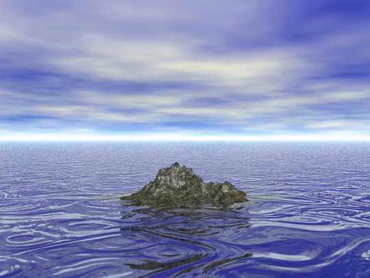

    I upped the X to 200% (from 1.5%!) and now, without having to move the camera back, and resize the island to get the right mix of island textures and water textures,
     I had a wind-blown water surface! Too cool.
    This also works when you're standing on a landscape close-up and it looks like huge chunks of plastic have been carved out of the terrain. Crank up the frequency (play with the A/B/C/D channels - one or all) to get that local surface back into the look you saw from far away...

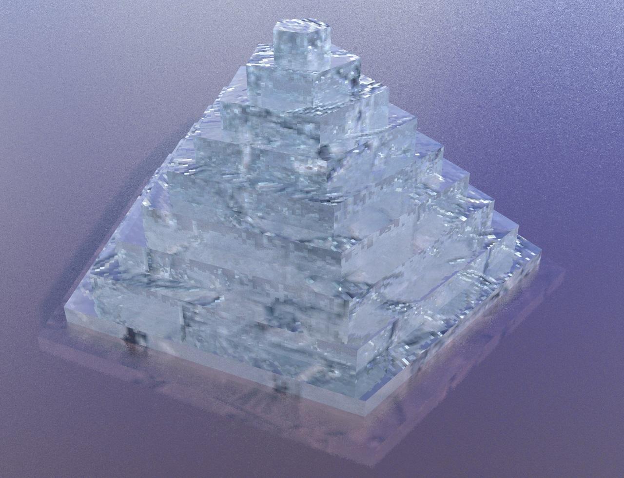

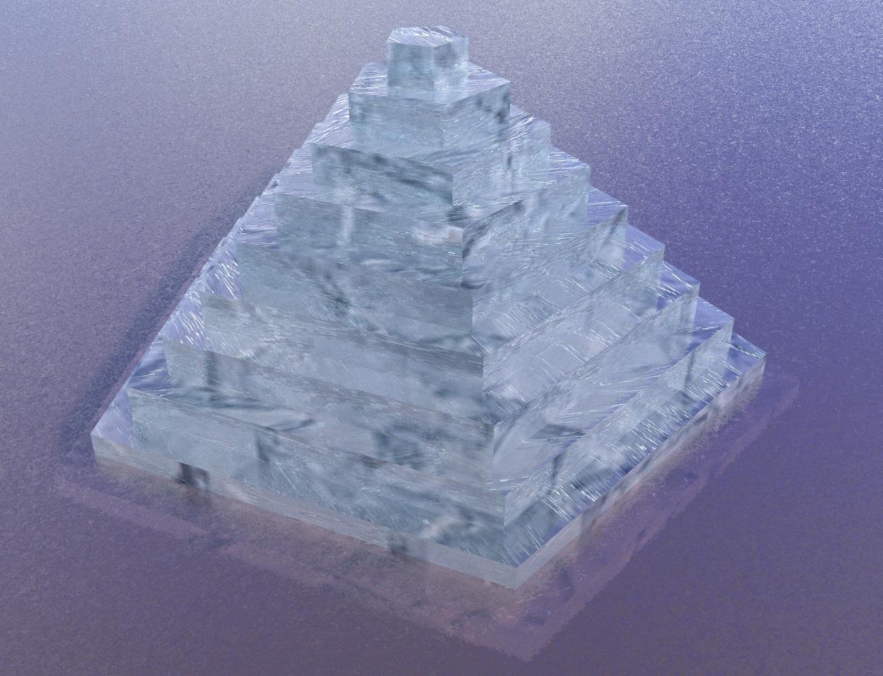

    This is very useful for any kind of materials, I think. I have changed the X frequency to 25% and got much nicer pyramid look
    than when using the default X 0%

    great - you can also *really* stretch the effects by going to values I would have previously thought were extreme, like 250% or 2500%, but in bryce, all values may prove valuable, even if it may not have been what you thought you wanted! You can also go negative, or really close to zero (e.g. 0.001), and/or only change a single axis, rather than all three (my usual is all three).
    Lastly, if you like the general texture, you can sometimes improve your use of it in your scene by using the rotate and translate options. I use those one at a time (x or y or z) to move clouds around in a sphere (fine tuning), or to adjust textures on a terrain that might look better if shifted a bit in some direction.
