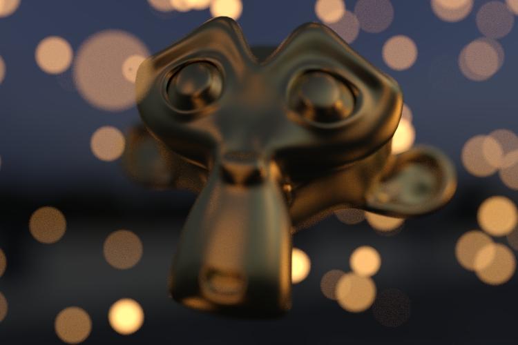

    The biggest issue with bokeh, and dof in general, it it takes a lot of iterations to get nice and smooth, like, a lot. Complex background + Needs more than 2000 iterations = not on my computer :(
    For fun, suzanne + icospheres ported over from blender, but for rendertimes this took 10 minutes and the dof is still rather noisy still

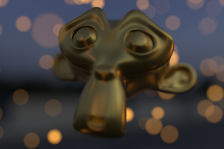

    Moar expiriments!
    The same scene in blender (there are marginal differences to the dof as they don't really transfer over so it was more my guestimates, I do think cycles dof gets smoother faster for whatever reason, also this render only took 5 minutes, but who knows)
    Dof in Iray again, but with some of the new camera features, I love that there's one to make the bokeh more ring-y as thats something thats generally viewed as a negative in real world cameras, as are stong bokeh shapes tbh, but hosestly I think the shapey bokehs look cool. I didn't let this one cook near as long, in case you can't tell, more just a quick poc.
