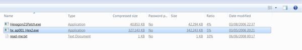

    Well I've poked about in my Downloads and found Hex 2.0 albeit part of the patched 2.1. I have a vague recollection that 2.0 was released; to be fairly quickly followed by the patch and it was the originators that released it, before Daz came on the scene.

    2.0 was the one I first bought when it was released. The 2.1 fix was the last one that the Eovia team made before Daz took over it all.
    2.1 is more stable then the 2.0 one. And it is also the only version I'm using that don't crash.
