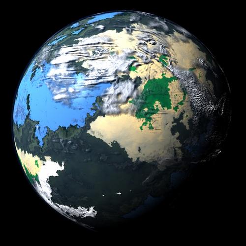

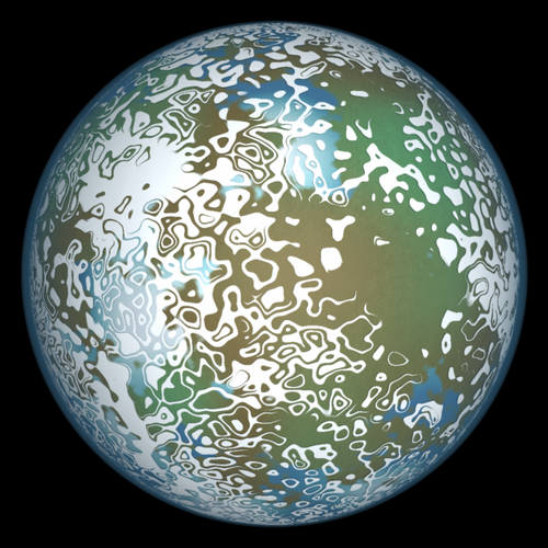

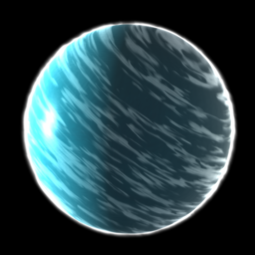

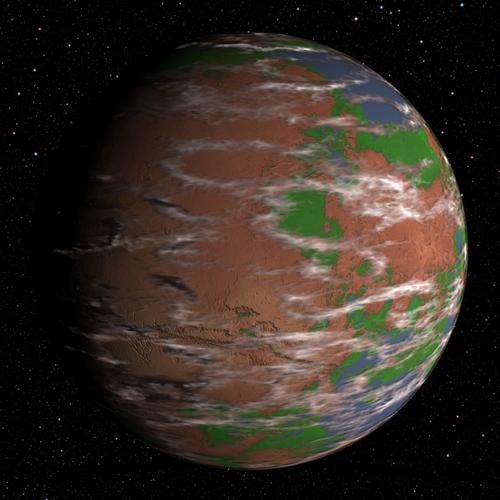

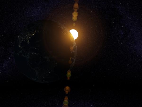

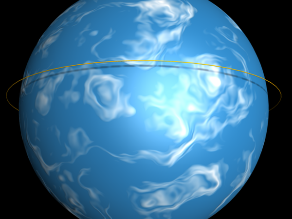

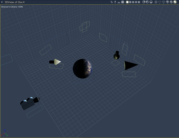

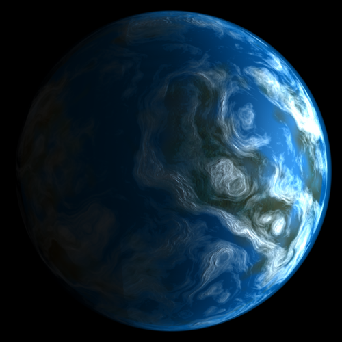

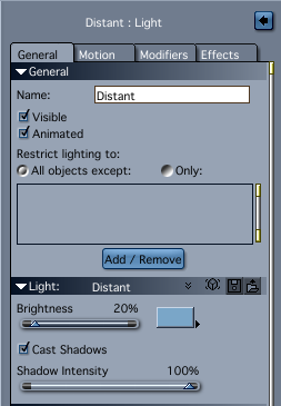

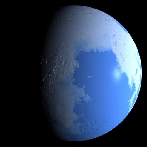

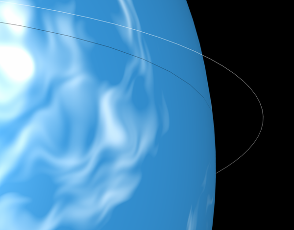

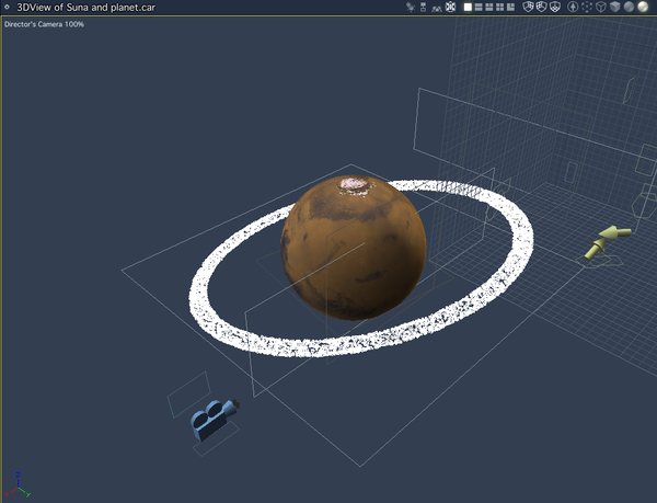

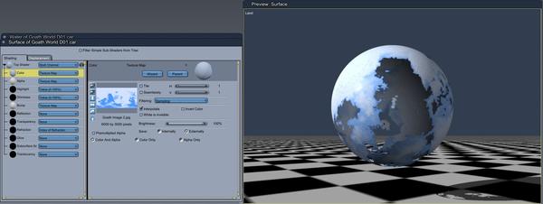

    I set the scene up with the model and three lights. One bulb light, one spot light and one distance light. I set the scene's ambient light to zero.
    The bulb light is just the default settings. I used the bulb for the sunlight. I went to the light's effects tab and enabled the 3D light sphere and the lens flare. I'll include screen shots of what I did. The Light Sphere makes the sun's disk and the lens flare is self explanatory. A bulb usually works better for this than the distant light, as the distant light doesn't have the Light Sphere under it's effects. For the lens flare, I dialed the radius down from it's default. I could have gone for a smaller radius on the light sphere as well.
    The spotlight is positioned to provide a rim light or crescent on the earth model, because the bulb light doesn't light enough of the Earth relative to the camera. This is completely incorrect I know. Consider it artistic license. Be careful though, or it goes from taking minor liberties to taking your viewers out of the picture. I'm actually pushing it a bit myself, but I wanted it to be fairly obvious to illustrate my point.
    The distant light is used to provide a low level fill light. I could have gone a bit brighter in this scene, but my model uses a sphere with a glow channel to simulate the atmosphere, and if I had it brighter, it would show the effect up too much. I also have a nice glow channel for the surface to simulate city lights and I wanted that to really stand out.
    The position of the lights relative to the model and the camera is scene specific, but generally I like the low level fill light coming from maybe a 45º angle from the camera, aiming back towards the primary light. Again, this is scene specific, and depends on what you're going for.
    The other thing to consider is your color scheme. If I'm doing a scene with a fairly pedestrian star field, I tend to have the primary light a yellow/white color and the fill light a blue/grey color to match what I imagine the star shine would look like.

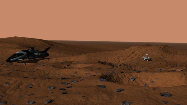

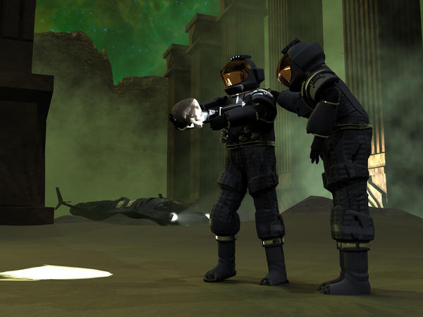

  • JoeMamma2000JoeMamma2000 Posts: 2,615
    Ooo, can I play too ??
    Okay, I really suck at space stuff. Partially because I guess it bores the crap out of me. Unless it's like really surrealistic and gorgeous like some of the nebulas and that kind of stuff. But I'm not much into spaceships, etc.
    But I do see a lot of repeating practices that people might want to reconsider.
    First, cameras in space operate under the same principles as they do on earth. When the scene is dark, and the subject is relatively close or zoomed, then stuff in the background is usually blurred due to a shallow depth of field. And adding DOF helps to give a sense of distance, which is often missing in space-y renders with spaceships that are thousands or millions of miles away from planets and stuff. Unfortunately it obscures that cool planet you spent so much time on, but I think it adds some realism that sells the image a bit better.
    Now of course, bright subjects and wide angle lenses increase the DOF, so you wouldn't see it as much in that case.
    Second, objects in space still interact with light from other objects. Including planets and other ships, etc. And that's very important to place the object in the scene, instead of making it seem like the objects were copied and pasted into the image. So if you have a spaceship that is nearing a planet, the reflected light from the planet should interact with the ship. Also the sun/moon/star light should interact with the ship. And so on...
    Also, textures are real important on spaceships. Often you'll see real dull, uninteresting textures with no light interaction whatsoever, and it just looks like a plastic model was stuck in the image. And engine glow should be made interesting, not just a single color that looks like a bad Photoshop splotch.
    Here's a crappy, standard spaceship image with some depth of field and reflections of light to clearly place the ship in the scene. I think the DOF is way overdone, but I'm not sure. If you check some real life space station photos and stuff you see the DOF when the lighting is low, but I don't know, it just doesn't look right. But anyway you get the point. And I made the spaceship a shiny metallic to enhance the reflections and interest.
    Again, don't take the image as a good example because it's sucky and boring, but hopefully it illustrates the points.

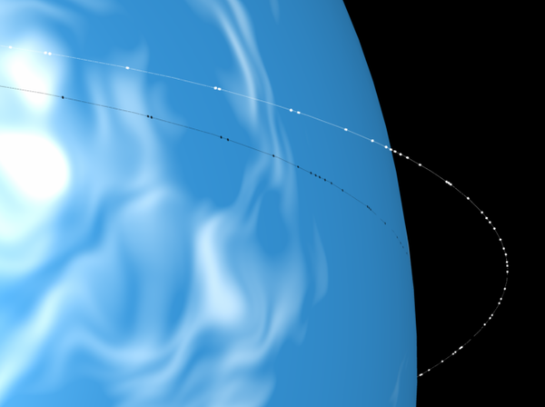

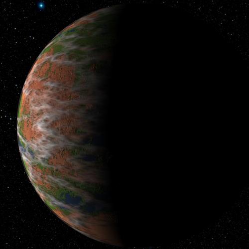

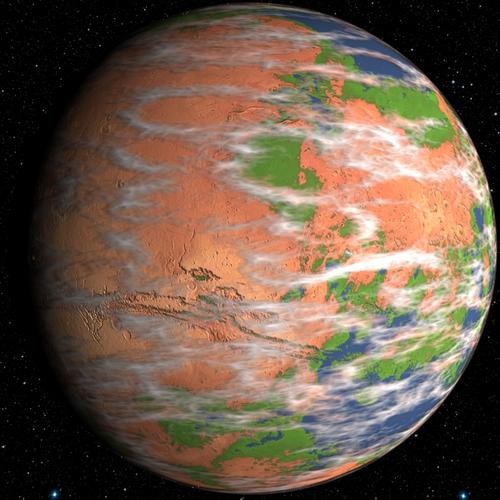

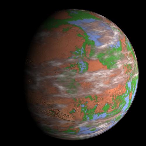

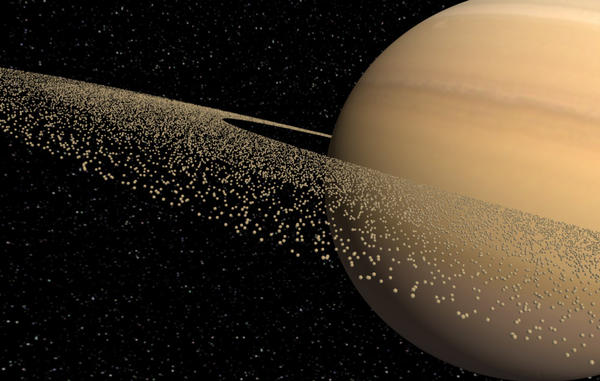

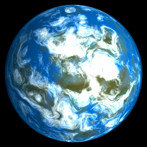

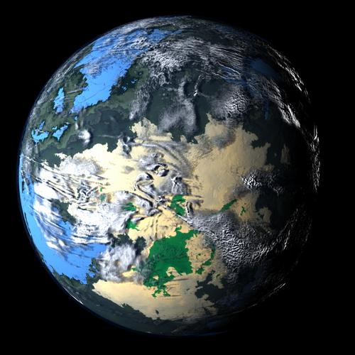

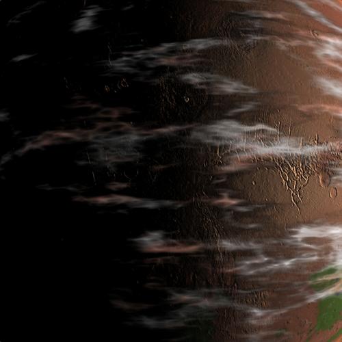

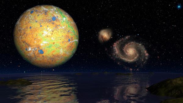

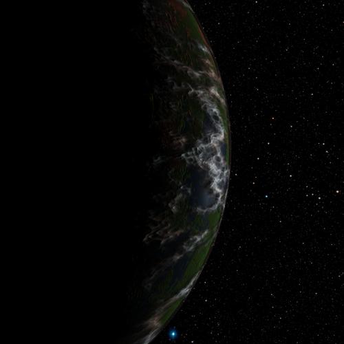

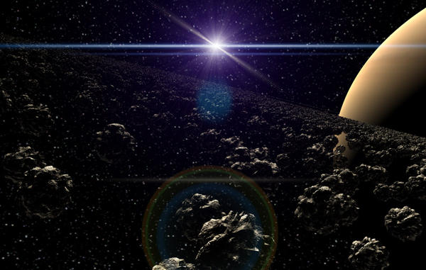

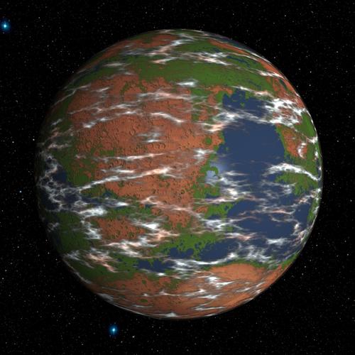

    Forever ago I was trying to create all of outer space with the Primivol plugin.
    My usual style is to nod politely towards realism and then head straight to the FLASH GORDON end of the spectrum... I'll have a Sun Shader tutorial in a few but here's some of my Primivol efforts:

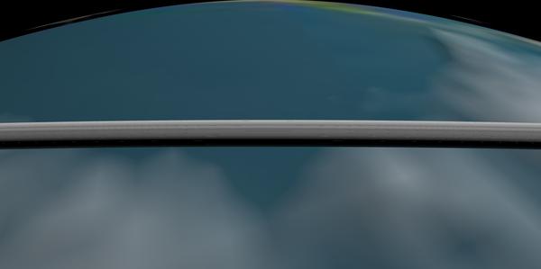

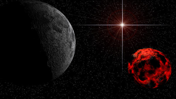

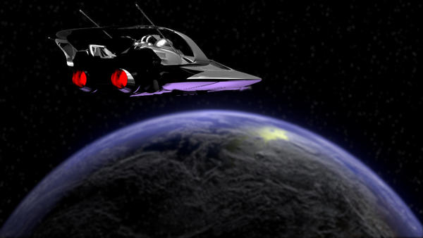

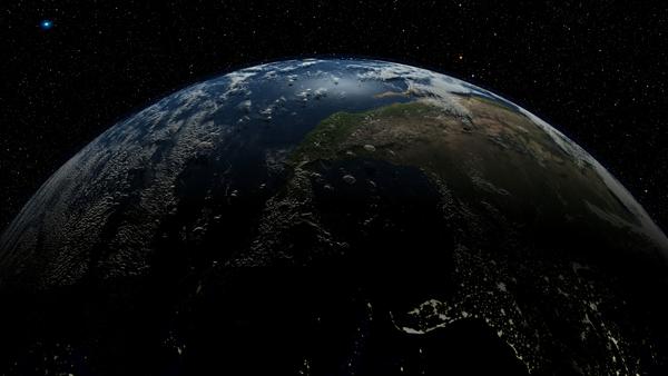

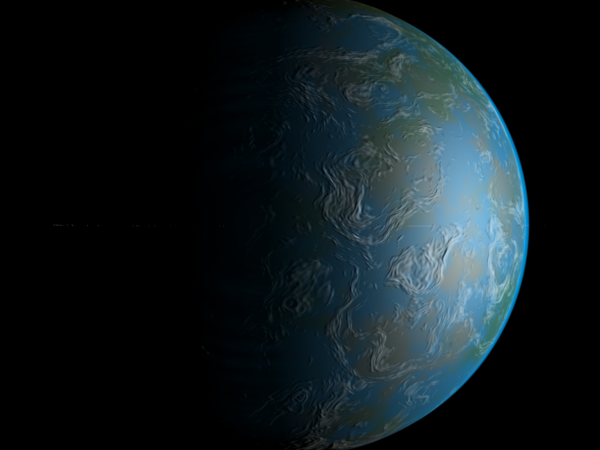

    When I do a space image and I want DOF it can be difficult, because as JoeMama said, there's incredible distances involved, so I tend to force the perspective. The built in DOF isn't that great either, so what I use is a depth render pass available under Multi-Pass in the Render room. It creates a greyscale image that can be used in Photoshop (and I assume other sophisticated image editing apps) to create a layer mask. Unfortunately, the depth pass doesn't respect alpha channels, volumetric clouds, hair, or primitives such as fire, fountains and fog. If you have any of those, you'll have to edit the depth pass image.

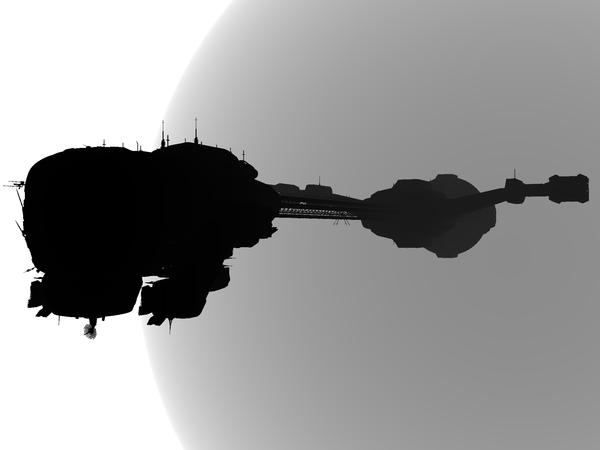

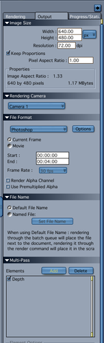

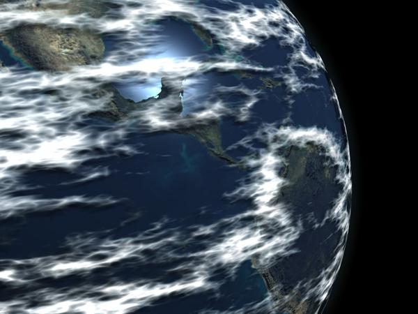

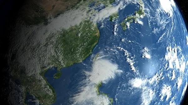

    The following picture uses a depth pass for DOF. I'm still working on the shaders and lighting for this one, and I may change the background planet as well.

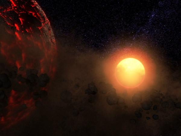

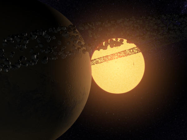

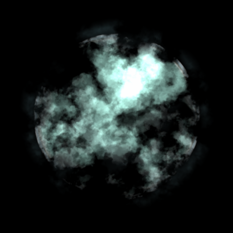

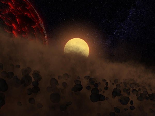

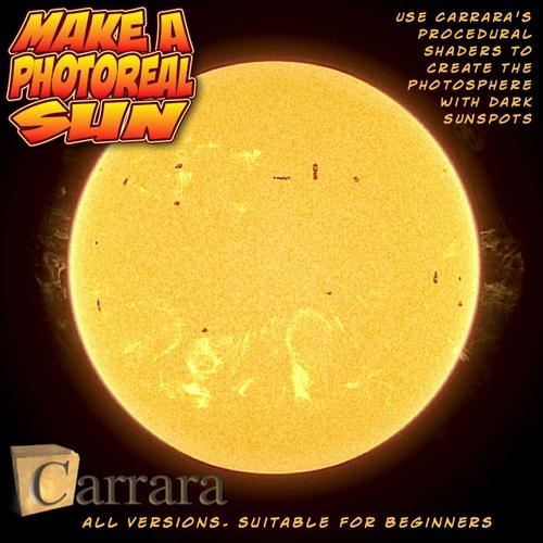

    Here's my tutorial topic: a "Photoreal" Sun....
    I put "photoreal" in quotes because what the sun really *looks* like to the naked eye seems to be debatable, and also what structures we want to show of the sun is definitely subjective. But I'll post this "final" render while I organize the tutorial...
    The pic uses Primivol, but the tutorial is going to focus on the surface shader, so Primivol won't be needed...

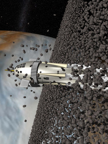

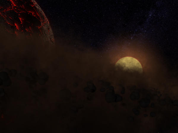

    Good point about the interaction of objects.

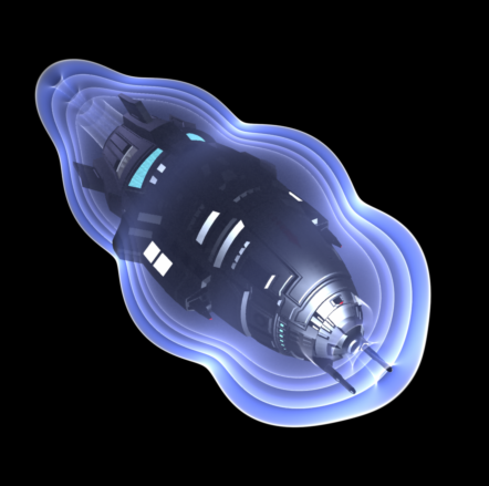

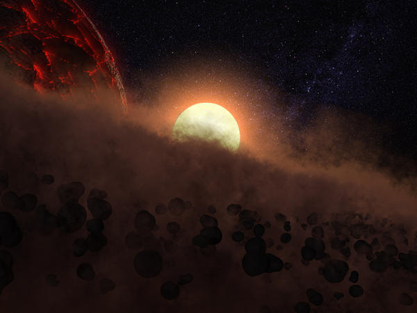

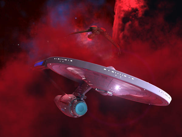

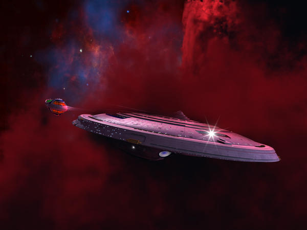

    One of my favorite scenes that I did used a photo of a nebula that the Hubble had taken. I used that as a backdrop for my scene and used a couple Star Trek models bursting out of a volumetric cloud that I had colored to match the nebula. I did quite bit of work on getting the lighting to match.
    I did two versions. One with a more modern style ship and another with the classic movie Enterprise and a classic Klingon Bird of Prey. I tried an experiment with the model of the old school ship and added the NASA image to the scene's background and enabled the Skylight, so it would act like an IBL. I like the effect, but there is quite a bit of noise/ashiness in the image and in my opinion not worth the render time.
    The image with the more modern ship is just the standard renderer with no bells and whistles.
    2000 x 1500 - 565K
    2000 x 1500 - 667K

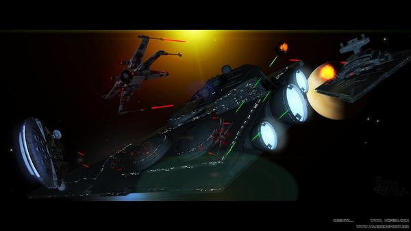

    Funny that you should say that, because the top three images are built in the same scene and have exactly the same light rig, the only thing that changes is the camera position and treatment in post. It's based on a 2 point binary star system.
    If you really want accurate deep space lighting then you're only allowed one light source with very local indirect light. When close to a planet, moon or nebula the reflected light becomes significant. Ship running lights or space station floods are very handy. The NASA nebula pics are enhanced and colour shifted to make them more attractive but I say 'what the heck, if that's what works'.
    The composition is a personal choice to indicate a building battle and confusion. A personal choice and necessary to the story, so I suppose that's the intended reaction from you. I know that I miss on composition sometimes but I get very few critiques, so thank you for that.
    The first one looks good (has more depth and feel of motion) because I massively forced the perspective. I boosted the ambient in post to give more pleasing shadows. I used the same tricks on the last one and but also lit counter intuitively to the background. The framing on both helps to sell the sense of motion, something that the panavision aspect ratio is really good for.

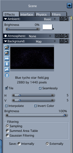

    The setup is one distant light (soft shadows) to act as the sunlight. A bulb (turned down) is parented to a glowing Sun object to provide the disc and the flare at the right time. Another distant light is shining up through the earth to provide a little reflected light.
    The final light is a spot parented to the camera to provide a floodlight from the 'orbiting' shuttle camera. That's why you can still see the ISS all the way around.
    And that's it for the lights, zero ambient.

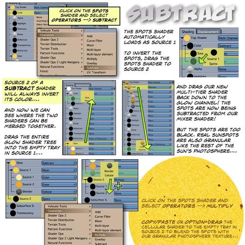

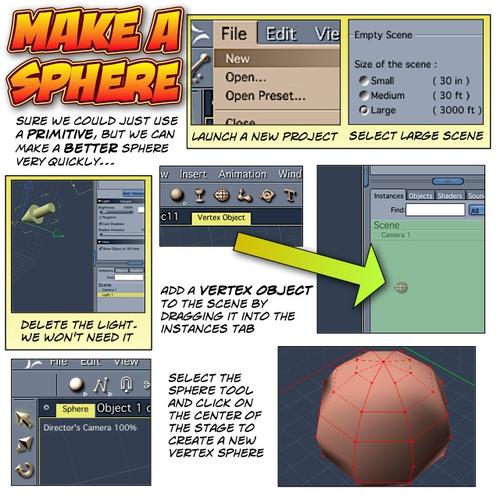

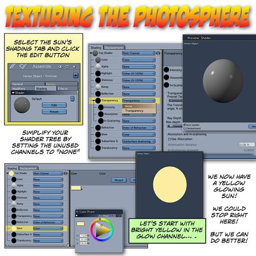

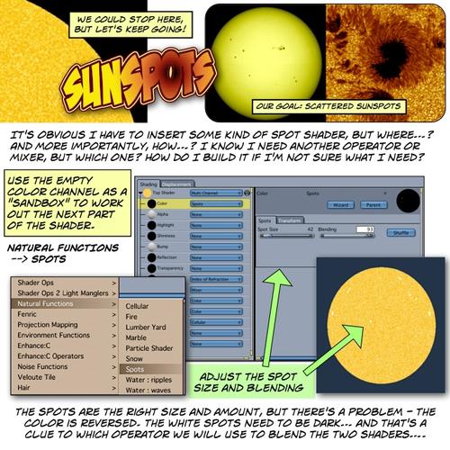

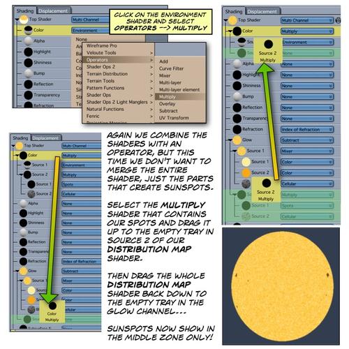

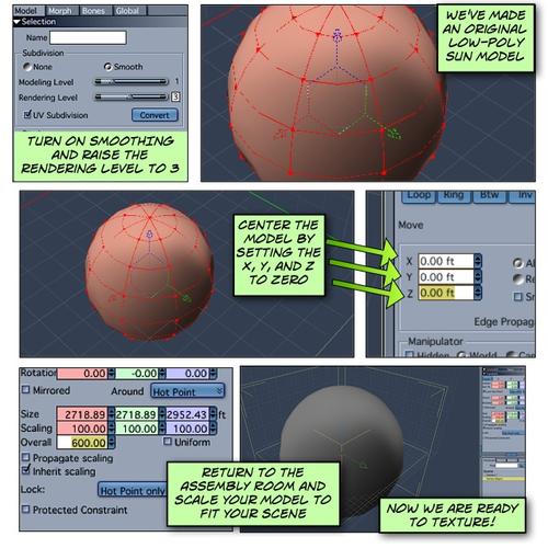

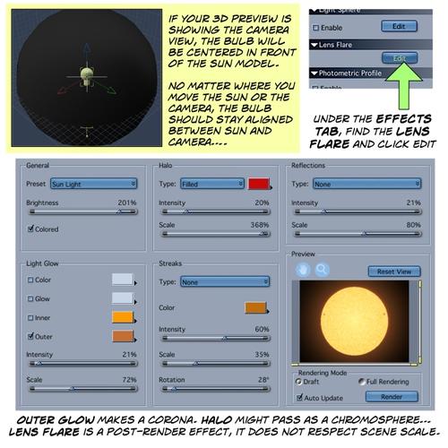

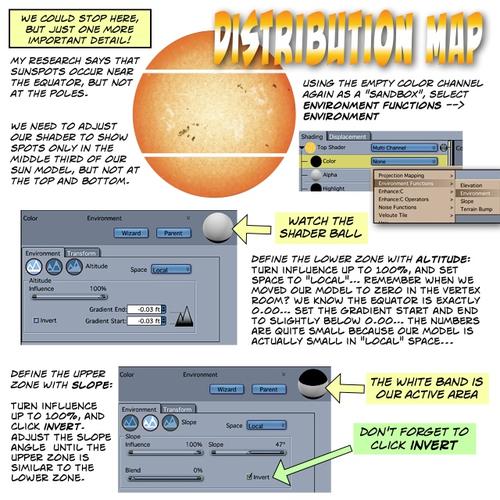

    Ok, here's the first part of my SUN TUTORIAL in Comicbook format™... YAY! :coolgrin:
    Step-by-step, and suitable for beginners! This section covers building a sun model and texturing the photosphere with sunspots. I had to stop there because it has been 3-days working on this and I need a break, lol. Also the next steps require plugins and elaborate "tricks" to get the effects, so I will add them later as "bonus" pages...
    Eventually I will put it in PDF and upload it to my website... or maybe CARRARA CAFE would be so kind as to host...
    Please let me know if any part is unclear or contains typos or mistakes....
    640 x 640 - 197K
    640 x 640 - 276K
    640 x 640 - 185K
    640 x 640 - 188K
    640 x 640 - 179K

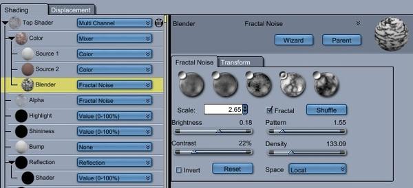

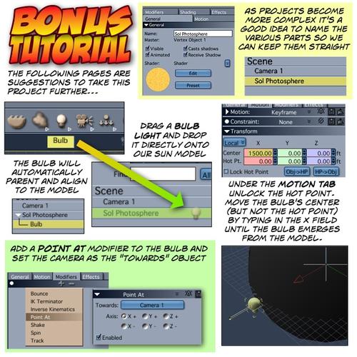

    Sun Tutorial continues...

    edited December 2012
    Sun tutorial continues...
    640 x 640 - 247K
    640 x 640 - 208K
    Post edited by wetcircuit on
    Final panel....
    640 x 640 - 215K
    Thank you for your hard work Holly! I'm going to DL and go through the process step by step!
  • RoguePilotRoguePilot Posts: 239
    Yes, thanks for that, I always love your comic book style tutorials.
