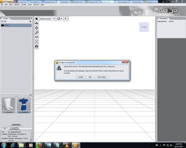

So I downloaded it fine and it showed up in the appropriate box on my Daz 3.1 but I tried loading it and I get this (in pic) what does it mean? has anyone else tried to use this? has it worked for them? this is a shame because its hard to come across anything Chun Li related for Daz and I found this which is perfect but it does not work when it should.
Help would be appreciated here please is there a way of getting it to work somehow or do you even know why that message pops up? ty.

    First things first is to go to where that box says ("Runtime/Geometries/StudioMaya/V4/...") and check to see if there actually is an obj there. It's possible that it's in the wrong location, the filename is wrong, or StudioMaya forgot to include it in the download.
  • GoneGone Posts: 833
    It means the path for the geometries is wrong.
    According to your message, it is looking for the geometry in .../studiomaya/v4/...
    The .obj's are actually in .../studiomaya/...
    You can either go to the geometries folder and add the v4 to the path and move the .obj's there or you can open the cr2 files and edit them to point to the correct path.
    While your message is for the dress, it may also happen fr the other obj's as well. There may also be similar issues with the texture files - I haven't loaded it so I can't say for sure. Hopefully, this is the only path error.
    Good luck.

    The Poser file is looking for the mesh (.OBJ) at the location shown in your picture, the problem is that isn't where the mesh is located, so DS gives you that "I can't find it" popup and wants you to find it instead.
    It's pretty common amongst Poser content, so get used to finding the files when asked or learn how to edit everything so they point to the right places.
    PS click "locate" and in the search window head to Runtime > Geometries > StudioMaya, you'll find the files in there instead where the Poser script says.

    k I did locate them yes I am confused as to what you mean add the V4 to the path? where exactly am I supposed to move the studiomaya folder to please. Sorry bout this.

    You don't move it, instead create a V4 folder inside it and move the 4 OBJ files into it.
