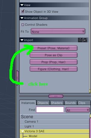

    just stick the pz2 files in your library under content/runtime/libraries/pose or for a non-Genesis figure above the scene tree under general is an import pose option, this option does not come up in C8,5 for Genesis, is also in other Carrara versions, in fact my only pose import option when I used C5pro so used to using it.
    303 x 457 - 39K
