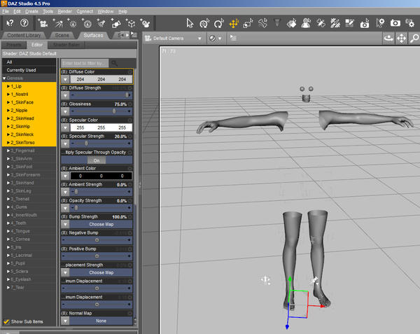

    You can do it in the Surfaces pane, and set the Opacity slider to 0% for a selection of Surfaces.

    I'm not sure if this applies to 3Delight or not, but turning off the bone in the scene file has a MAJOR advantage when exporting to external renderers, such as using Reality to export to LuxRender. When you turn off the bone (or turn off the surface in the polygon group editor -- which sadly is not saved as part of the scene file so you have to remember to turn it off again each time you re-load a scene), it prevents the geometry from being exported at all. If you just set the opacity to 0, you get the geometry with a material definition that amounts to the null material. The additional geometry thus takes more memory, and is also accounted for when ray intersection tests are performed, slowing down the render speed. It can also cause visible problems in the render, particularly when the null surface intersects another visible surface. It also acts as a volume boundary, which can cause problems when volumetrics like fog effects are used.
    A set of pose files that turn the visibility of various bone groups on and off would seem much more useful to me than a set of poses that just set the opacity of surfaces to 0 (which is what I assume the linked pose set does). Some clothing items even include such pose files. I agree it's a nuisance to turn off a bunch of bones manually (especially for things like the hands with all the sub-bones of the fingers) since the visibility icon in the scene list doesn't honor multi-select.

    Yeah, when I need to hide something like poke-through from of Genesis and I don't feel like using DForm, especially when it comes to autofit items like boots and breast-resistant tops, I just do what JimmyC_2009 says and turn off the opacity on the material zone. :)
