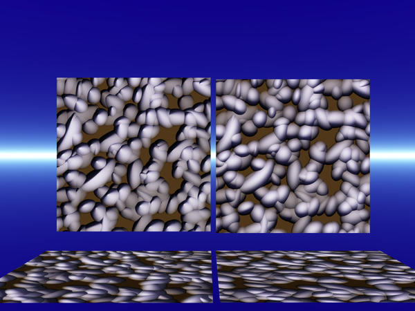

Len had wondered in one of his posts about Bryce 7.1's Enhanced Bump. So I thought I'd post some images that show the differences. My comments are based on the visual not the technical. I'll leave that to others, if they are so inclined.
The biggest problem with Bump mapping since B1 was that it changed, often radically, depending on orientation. This image shows the "Pitted Concrete" preset. The pits are supposed to be negative but as shown in the left vertical 2d rectangle, it flips to positive and it "shadows" as if the light is from the left when the light is from the right. The horizontal is correct. The right image vertical rectangle the Enhanced Bump correctly.
1000 x 750 - 210K

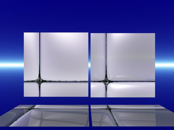

    This image show the correction of reflection and specularity with e-bumps.
    The old bump didn't react like it it was curved, so it didn't reflect that way or have specular highlights when vertical. The e-bump now reflects the horizontal rectangle and has some specular highlights.

    This last one shows how the old bump mapping has some really dark and ugly bump "shadowing". The e-bump looks so much better.
    So while sometimes e-bumps don't make a difference it's usually better to switch it over. As far as I can tell all the presets that come with Bryce 7.1 use the Legacy bump mapping.
    Oh - the Enhanced Bump is found in the Material Editor's Options popup (where the shadowing options are).
    1000 x 750 - 195K

    Hey Dan, yup, great examples of what changed with the bump-mapping :-)
    Can't remember exactly when he spotted it, but it was clever-dick Brinnen as usual, and I remember ranting-on about needing an Anisotropic shader and David asking me for a demonstration of it. I pointed out a Hi-Fi volume knob to him, and just as I thought, he tried doing it without a real shader. What became obvious is that using the old bump was faulty because the grooves he'd created to mimic the diamond cutting were getting ignored, and even if it had worked, there would be horrible moire anyway.
    On that knife render of his, the one with the grooves in the floor, that would never have been possible without the bump fix because Bryce's bump-mapping vectors were pretty screwed-up. The shadow would have been solid across the grooves. David got pretty obsessed with this bug and eventually it got fixed.
    It's just one of the niceties Vasily was able to work out and fix, not a new feature, but really important.
    Thanks to them both, I can render some vinyl :mrgreen:
