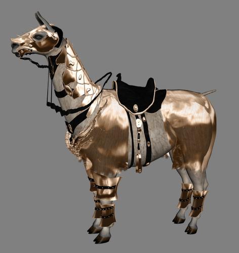

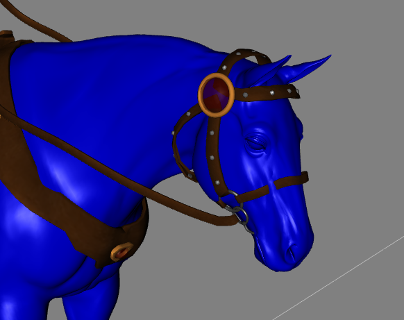

But first... why would one want to do this? Well, thanks to the aforementioned Millennium Horse clone shape for Horse 2, I was able to refit Spinebender Armor to the Llama! (Ok, I acknowledge it's a bit lumpy in places, but it does work!) But... what about the Astral Armor??? That was designed for the Charger, not the MilHorse!
If this image doesn't turn you off completely, read on. ;)

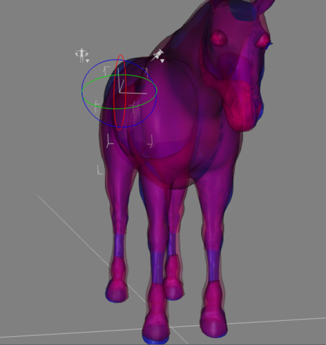

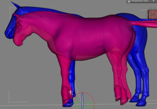

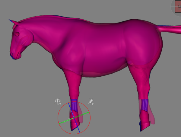

    Ok. Where I start with clones is to load both figures into the scene, set them to two contrasting colors, and make each only 50% opaque. This helps me to see how different they are.
    So here's the Charger (in fuschia) and the Horse 2 (in blue). Note that Horse 2 is longer than the Charger, and the base pose is also different. So the first thing I'll be doing is adjusting the overall length of the Horse 2, and arranging the pelvis of H2 to match the same area on the Charger.

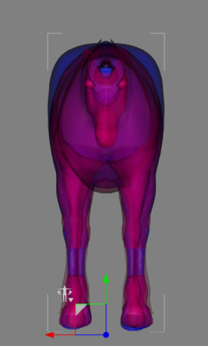

    Sometimes when I'm working to line things up, I like to use different views. Here, I've made a first pass at lining up the legs, though the head is still sticking out.
    218 x 484 - 90K

    Now I'm starting to get closer. I found the fetlocks of the Charger were making it hard to see how well the feet lined up, so I made them even more transparent. I could have hidden them altogether, but then there would be a gap in the Charger's legs, and I thought that would be more jarring to work with.
    Also note that I set the Charger (and its tack, not shown here) to be non-selectable in the scene, so I wouldn't click it by accident.
    668 x 506 - 198K

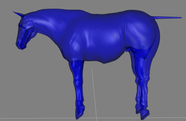

    So really I just keep fiddling with scale and rotation parameters per joint, working outward from the pelvis area. That point needs to stay fixed, so it's easiest to adjust the parts of the horse closest to the pelvis first. A couple of times I had to go back and fiddle with the pelvis position and redo work in other places. :(
    Also remember to keep checking from different angles.
    Occasionally I like to turn off the target model (Charger, in this case) and see what the "morph" is looking like. It will probably always be ugly-- we're never going to use this shape in a render. This is just being made to tell Horse 2 how to stretch and smush gear for the Charger to make it fit.
    (Also, remember Horse 2 is semi-transparent here-- the gullet isn't really protruding out of the head.)

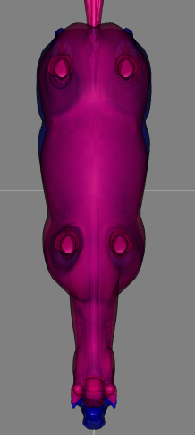

    Although I usually start with orthogonal views (Left, Top, Front, etc.), eventually I start rotating the Perspective camera around to see how things are lining up. One important point-- as much as possible, try to do right and left matching joints at the same time, and while you'll probably eyeball the first one, make sure to copy the numbers to the mirror joint exactly. Here I have the left front hoof not matching the right because I forgot to change the y scale of one of the joints.
    522 x 553 - 219K

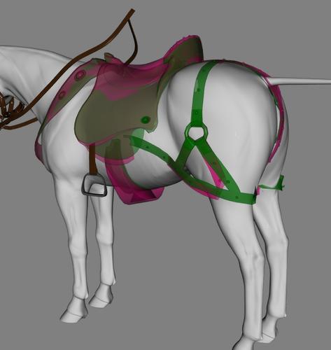

  • zigraphixzigraphix Posts: 2,787

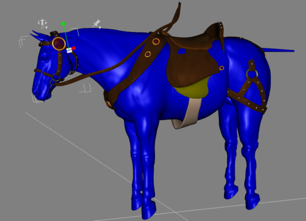

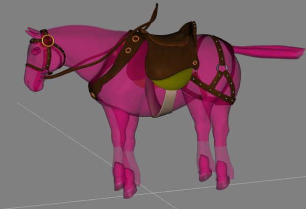

    You're never going to get a 100% fit just by scaling and rotating joints. But I got pretty close! Here's the original Charger with tack, and a semi-transparent and opaque version of the Horse 2 as I have it now, with the same tack (actually still being worn by the Charger, but the Charger is hidden).
    687 x 497 - 196K
    714 x 497 - 226K
    761 x 520 - 224K

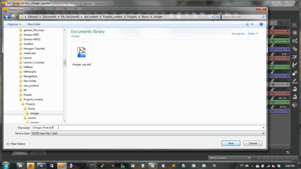

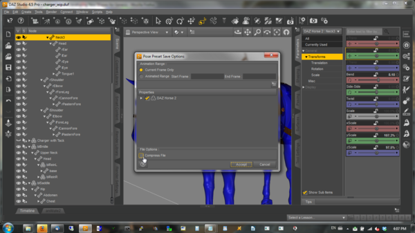

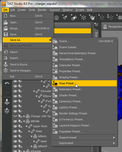

    Remember to save your work regularly. If you try something you're not sure about, save as a new file name, so you can get back to whatever you had before. (mjc1016, sounds like you need a UPS now....)
    Everything we've done up to this point has essentially been a "pose" for Horse 2, so you can save out your current work by selecting Horse 2 and saving the pose.

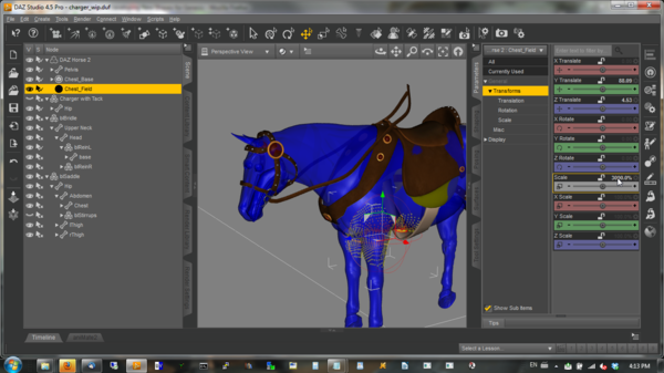

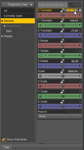

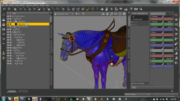

    To use DFormers with Tri-Ax figures like Genesis or Horse 2, you must select the main node of the figure when creating the D-Former.
    I recommend hiding the Charger at this point, but don't delete it from the scene, as you'll want to make it visible every now and then to check your progress.

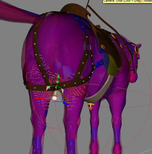

    For some reason, the D-Former field is always created as this huge thing. Crank the size of the field down to 3000 or so. You'll find that the system will probably respond very slowly until this step is completed.
    Then, maneuver the field into the position you need. We're going to work on the chest first. After I've resized the field, I usually parent the D-Former base and control to the field until I'm done moving it and angling it the way I want. Then I parent it back to the main node of the figure.
    1366 x 768 - 506K
    1366 x 768 - 588K

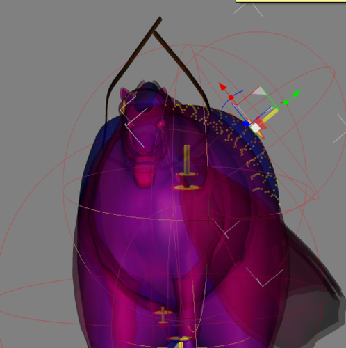

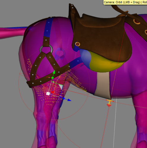

    After a lot of fiddling and trial-and-error, I ended up angling the D-Former a bit, and narrowing the width (x axis) to pull in the sides a bit.
    540 x 542 - 383K

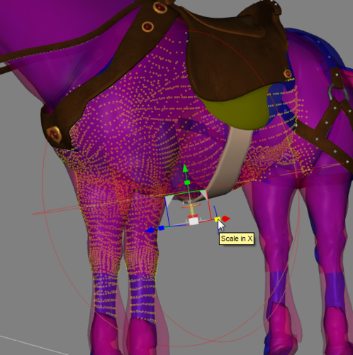

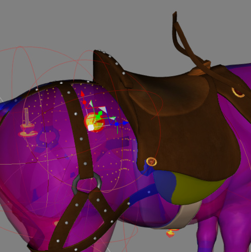

    Even though D-Formers are attached to the root node and can cross body part boundaries, you'll often find them easier to control if you don't try to do too much with a single D-Former. I found that I really needed separate ones for the chest and belly.
    The last thing I did today was make the rump bigger, overall, but then nudge in the "hips" a bit.
    Then I had to duplicate the work on the other side of the body. I used "copy selected items" and "paste to selected items" to get the parts of the D-Former into the same position as the one on the right, then reversed the x-trans and z-rotation to move them to the left side.
    More later -- I need to go make supper! :)

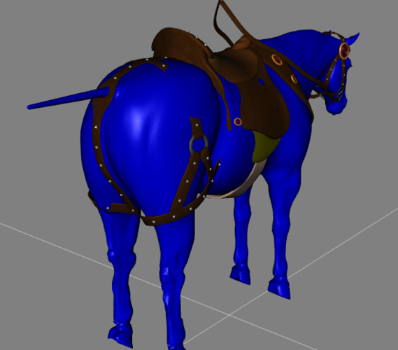

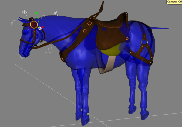

    Ok. I exported the altered beastie as an obj, brought it back in as a morph, did the Freeze ERC thing with the appropriate pose, but I'm having some scaling and translation problems with the final result.
    Here's the result now.... with just a bit of cheating. Namely, I loaded the saddle and bridle, fit them to Horse 2, chose the clone Charger, let the refit happen... and then unfit the saddle and bridle and translated and scaled the horsie to get them back on to the horse. The saddle fit is much better than just repositioning the saddle: the green version is the refit saddle, the pink is the original. The bridle, not so much.
    So I'm not going to be posting the process until I manage to figure out what I'm doing wrong here. A couple of things have changed in DS 4.5 about how clones are handled, and I didn't have translation concerns with my previous clone attempts. But I'll get it figured out... eventually. ;)
    556 x 588 - 103K
