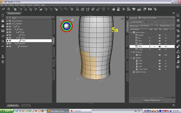

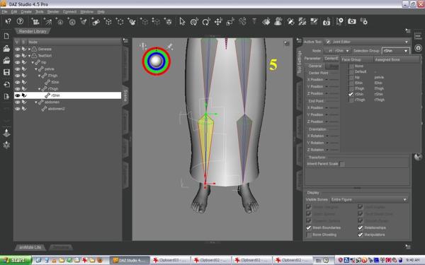

  • DaremoK3DaremoK3 Posts: 798
    Kattey's mini-tut:
    *Changing/creating new bones for Transfer Utility auto-generated long skirt.
    The following information is illustrated in the images below.
    *PART 1-4:
    1. Initial figure created via the Transfer Utility. All bones seen in Scene Tab on left, and bones actually used/assigned seen in Polygon Group Editor on the right. Note; Only hip, lShin, lThigh, rShin, and rThigh are assigned. All polys in each individual group adds up to the total polys of the mesh (256). No single polygon can be assigned to more than one face group.
    2. Example showing the default assigned bone/poly-groups.
    3. Here you can see "pelvis" is assigned to "hip" poly-group.
    4. Joint Editor Tool drop-down box where you select bone to poly-group assignment.
    ***Continued in next post...

    *PART 5-8:
    5/5a. Initial right shin bone, and poly-group assignment.
    6. Renamed rShin bone to rSkirt, but you can see that the poly-group assignment remains the same (rShin).
    7. New polygon selection for rSkirt bone. In Polygon Group Editor, right-click Face Group header (Face Group), and select "Create Face Group from Selected".
    8. Name your selection group identical to the bone it will be assigned to.
    ***Continued next post...
