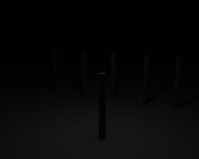

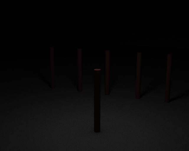

    One way of doing this is to up your luminence (light) LEVELS to have everything very well lit.  That will speed the render considerably.  Then you use the tone mapping shutter speed and f/stop, especially to set the exposure level you want...
     Both of these rendered for the same amount of time.  The first is with the light levels set for a low light render.  The second is with much more light and the exposure adjusted with the tonemapping.
    640 x 512 - 200K
    640 x 512 - 244K
    Post edited by mjc1016 on
