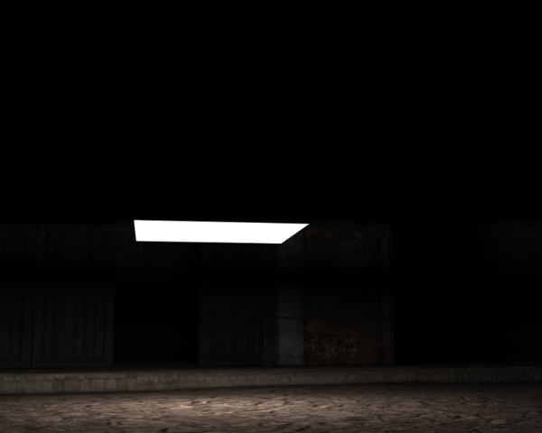

I've attached 3 example pictures.
In the first, the AreaLight plane has been rotated in the X to 120.5 and in the Y to 77.9. This should be angled UP at the wall but instead, there's no light above the plane.

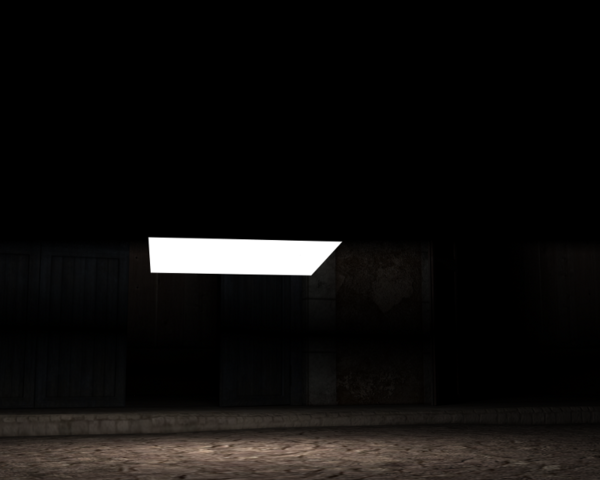

In the second example, the X has been rotated to 176.05 and the Y to 77.9. This should be almost straight up... but the light appears to be shooting straight down.

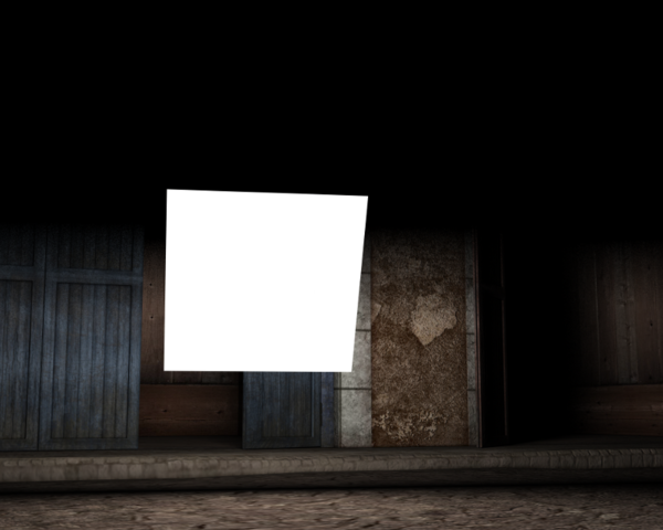

In the third example, the X has been re-set to 0. This should be sending light straight down and... it appears to be, although there's an odd line and it looks remarkably like the second example.

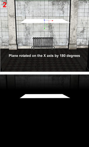

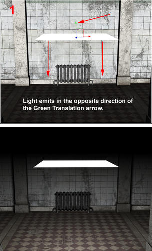

That is funny. When I apply an UberAreaLight to a plane the light emits exactly to the opposite direction as in Szarks screenshot. Means, on my system light goes in the same direction as the green translation arrow.
I hope DAZ or OmniFreaker or whoever will fix this issue. I really like the AreaLight but in this state it is a bit too much trial and error when setting it up.
