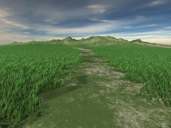

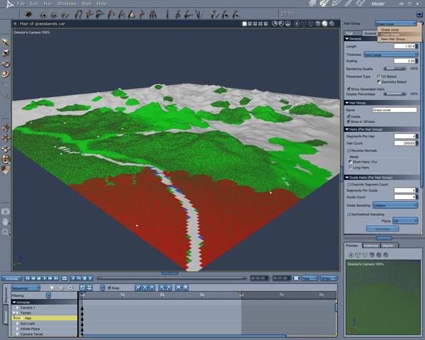

    In Carrara, you can use Dynamic Hair,. either as ....Hair / Fur :) , but it's scale can be Thin Medium Large or Extra large, so it's possible to use dynamic hairs, as a way of creating Grass, without modelling.
