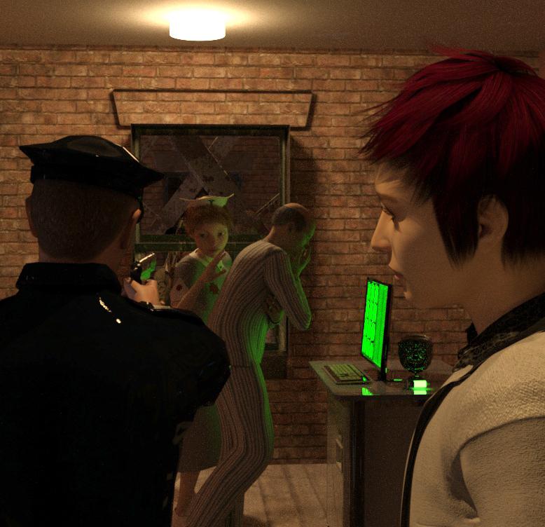

    Here is one with http://www.daz3d.com/real-lights-for-daz-studio-iray​. Applied the Monitor Screen setting to the screen and then taking the original diffuse map from the screen and putting it in the emmission channel andong with some green (it's supposed to be an old mono monitor. I lowered the Luminence to 900 to keep it from being too bright.
