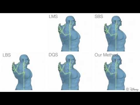

  • I would like to know as well, if there is a tutorial on how to export fully working Characters from DAZ to Unreal Engine, especially the Corrective Morphs. In blender it is perfectly possible to work with fully functional DAZ characters with help of diffeomorphic's importer. The Dual Quaternion problem can be solved too (modded version of Unreal Engine).
    In my view DAZ should get rid of all the Corrective Morphs and instead go for a better skinning method like "Optimized Centers of Rotation", which doesn't seem to need any corrective morphs:
    If Epic could do the same, than it would be perfect and it would work with every Character Mesh, no matter in which Software it was created.
