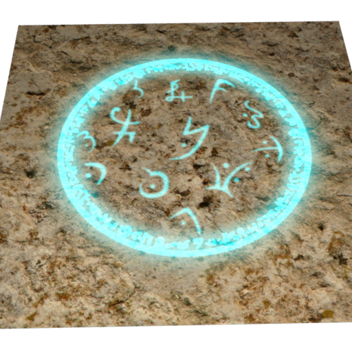

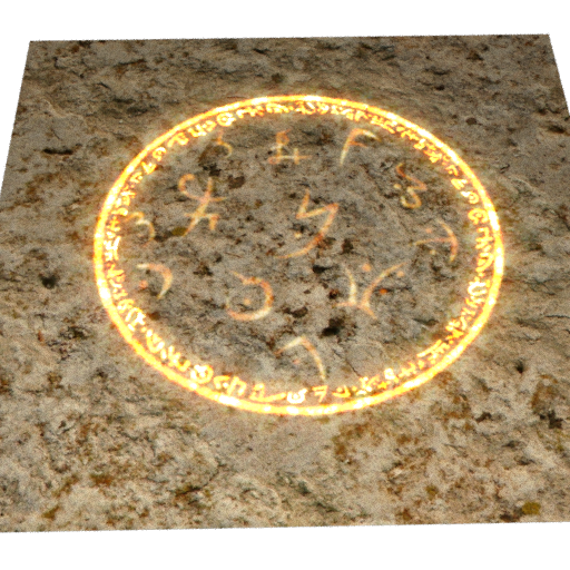

    Two related ways...the first requires making an 'emission specific' texture map.  You take the image into an image editor (Photoshop, GIMP, etc) and fill in everything you don't want to cast light with pure black.  This would preserve things like the 'lava' texture.
    The second, create a mask.  For the mask, everything that is white will glow...so make what you want to glow white and everything else black.
    You then place either into the emission channel.  Set the emission color to white for the first one and to whatever color you want the light to be for the second one.  Also make sure the color temperature is set to 6500.
    This is using a mask in the emission channel (second method)...
    And this one uses a texture (first method)
    512 x 512 - 482K

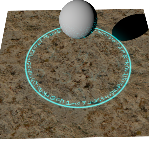

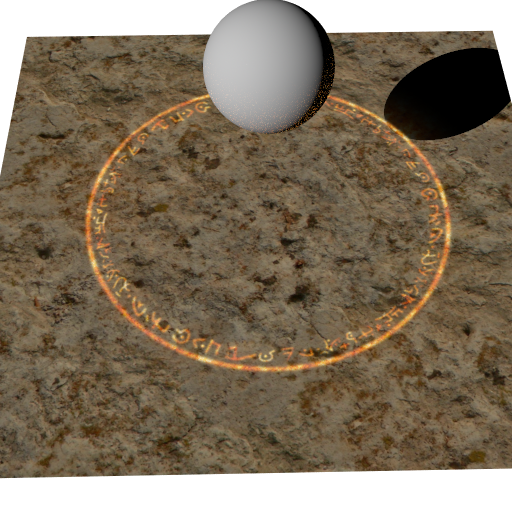

    edited November 2016
    The techniques work in 3Delight, also.  Use the UberAreaLight and then you just need to plug the mask into both the Light Color AND the Ambient channels.  Use the same color for both.
    512 x 512 - 453K
    512 x 512 - 450K
