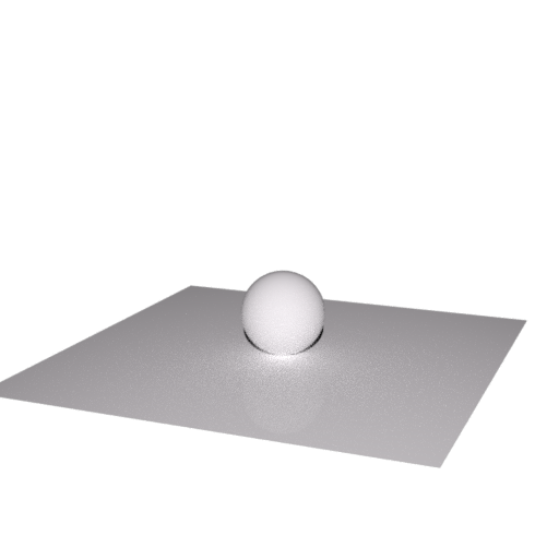

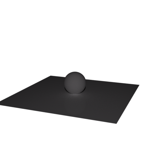

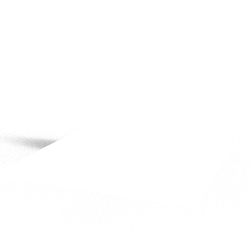

    edited November 2016
    Are you using Scene only or Dome and Scene?
    If Dome and Scene, is there an hdri loaded?
    Using your tonemapping settings and value on the spotlight....
    The first is Dome and Scene, the second is Scene Only.  The third is Scene only, with default tonemapping.

    I am using Scene only and a backgroung image is not necessary because of the perspective
    According to your examples the scene is between No 2 and 3, so I dont think the viewport is flashed  laugh
