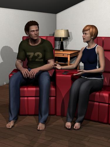

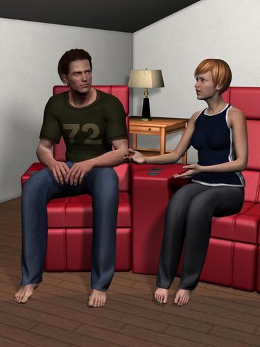

I have been working on some indoor scenes and trying to figure out how to light them to get realistic looking lighting. I have tried a lot of different things based threads I have read here and on my photography experience. Some things did not so at all as I expected, but I have found some things that are giving me pretty good results. I'm posting this thread to share my ideas and look for suggestions on how to improve the results.
The scene I'm using for this discussion is shown below. This is Michael 5 and Victoria 5 in the Media Room of the Dream House. They are actually sitting in the back of the Media Room, which has some funny shaped ceilings. There are no lights added in the image below. This is just the DAZ default lighting. Render time was 11s.
All renders in this thread were done with "Shading Rate" set to 0.2 the "Shadow Samples" set to 32.
600 x 800 - 231K
  • mark128mark128 Posts: 1,033
    It actually is not that bad, just a little dim.

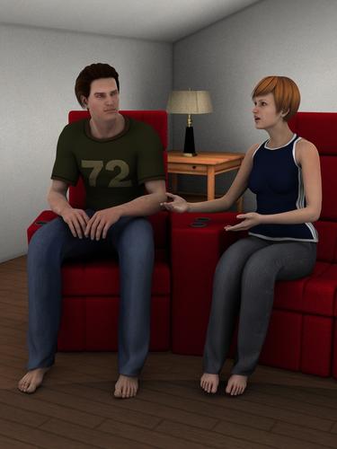

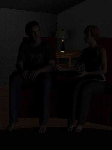

    The first thing I decided to try was the UberEnviroment2 light. I added the base light to the scene and the 4xHi quality preset. Then I changed the mode to “Ambient”. Render time was still 11s
    600 x 800 - 279K
    Well, that was a disaster. That lighting is not even good enough for bad comic books. Clearly not what I want at all.

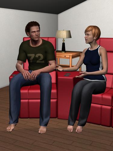

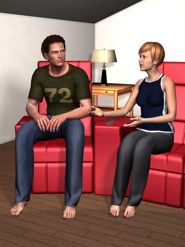

    The next thing I tried was to change the mode to “Occlusion w/Soft Shadows”. Rendering time went up to 1 min 17s.
    600 x 800 - 175K

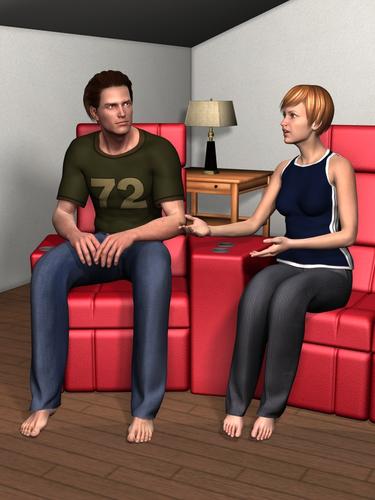

    That looks pretty dark. If I boast the “intensity Scale” to 1000%, then I get something like this:
    600 x 800 - 397K
    Not as dark, but horribly noisy. At this point I was not using a HDRI image on the UE2 dome. The dome is outside this room. The dome is lighting up the outside of the Media Room set, not the inside. The only light that is getting inside is coming through the window.

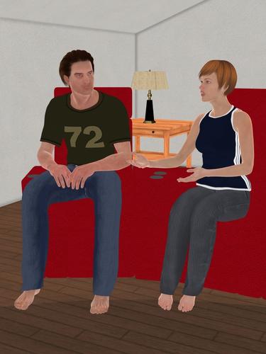

    I tried scaling the UE2 dome to be inside the room, but that did not seem to help. I tried putting the kitchen HDRI preset on the dome. That didn't help.
    At this point I decided UE2 doesn't work very well for lighting indoor sets, or at least I have no clue how to use it for indoor sets. I decided to move on and try some other kinds of lighting.
    The first thing I tried was to add Linear Point Lights (LPL). These are sort of like regular pointer lights, but much more powerful and you can control how far the light extends. I placed 3 LPLs in a row left to right and in front of Michael and Victoria and 2 LPL lights behind them. I put the lights well above their head levels, but not all the way up at the ceiling. The location of a LPL will not show in the render, unless it is right next to something to illuminate. In this case none of the LPL are actually in the render. I only put 2 behind them because of the room is narrower behind them and there was not room for another.
    I tweaked the intensity of the lights. Finally ended up using around 40%. I left the Falloff Start at the default 33. I set the Falloff End at 1000, so the lights would overlap a lot and even out the lighting. This is the result. Render time is 11s.
    600 x 800 - 282K

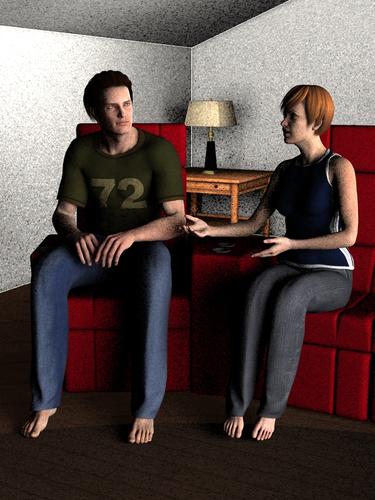

    This is starting to look like real lighting. The faces are still not lite very well. The LPL lights are set not to cast shadows, so we don't really get the shadows you would expect from overhead lighting. The next thing I tried was turning on ray traced shadows on all the LPL lights. Ray tracing all those shadows did not come cheap. Render time jumped to 4min 49s.

    Your problem with UE2 using occlusion was the trace distance - by default it's too high for interiors, meaning that the walls block all of the light - lowering it to something like 100 or less would allow occlusion from the furnishings and figures without killing all of the lighting.
    I reduced the trace distance to 100 and tried again with only the UE2 and set to occlusion soft shadows. The result below is much improved over the ambient mode image, but it has issues. I could certainly brighten up M5 and V5, but I'm not sure how to make the wall illumination more even.
    I tried mixing this lighting at 10%-20% with my LPL and UALP lighting, but it did not seem to fill the shadow areas as much, which makes some sense since occlusion is suppose to be creating those shadows.
