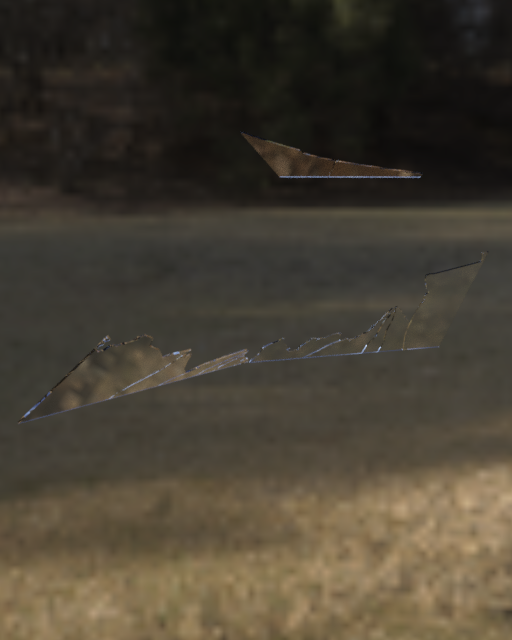

    Are you using the Iray glass presets?  If not I'd reccomend trying one of those first.
    Make sure Cutout opacity is at 1, and you'll want to set Thin Walled to off and Abbe to at least 55 (these are taken from the glass dispersive preset that comes with the Iray shaders)
    I've attached a quick, not even complete render of the Glass, Solid, Clear dispersive rainbow preset as an example.

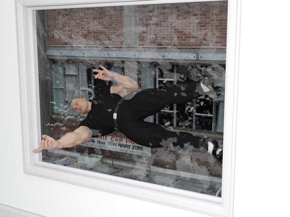

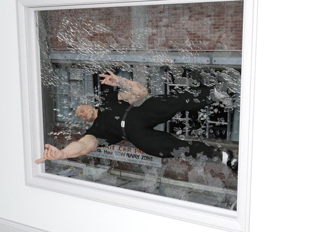

    Thanks for thos glass settings. They really enhanced the look of the glass.
    After
    Before
