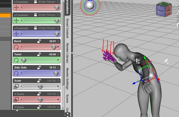

  • kitakoredazkitakoredaz Posts: 3,526
    about active poze tool, there are another problem,,
    I can translate rig,, without move pinned node ,, but it can not rotate fee,,
    so,, if I hope y rotate(twist) abdoman2 with keep hand pisiton,,I need to change tool,
    I can not do it with active poze tool,,,
    then,, I may select left hand and all child node, in scene tab. then use pin tool, fix rotaiton and translation,,
    need many pins for fix hands ,,
    but they move,, actually,,even if I keep limits of plevis twist,,
    I am now laugh,,because the hand move much with many pins ^^;
    now hand positon is different from what they were,,
    (so I can not say "pin work well" ^^; it seems break pins)
    379 x 274 - 19K
    747 x 489 - 74K

    about the picture,, ,, I rotated with pins by" usuall universal too"
    when translate rig "Active pose" work fine, but I have known, it can not rotate rig,,
    But,, DS pins seems not work good when Universal pozing tool.(not select Active pose)
    these pins not perfeclty fix the rigs,, I hope , just stop controller.if it can not rotate any more
    (over limits of pinned node) .
    I wanted to say what you mentioned, so stuck above pics ^^;
    Of course I use IK ;-) , I checked how it work when check off IK,
    just the rig I select can rotate with childres rigs,, it may be useful when I hope so.
