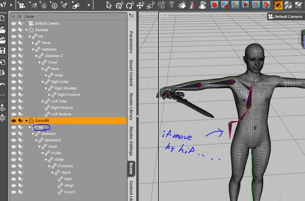

    you can check easy,, how the figures (of your items) node arrange,,and how it move.
    by scene tab, and bone visiblity setting.

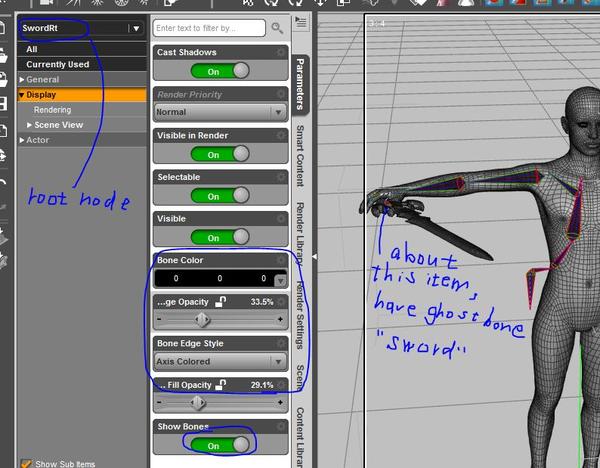

    select the item root, in scene tab, then go to parameter tab,
    and change setting of bone visiblity in paramete tab display mode. (need to change opacity too,,)
    after that,, you can check which bone is best when you adjust the positon.
    there would be more suitable bone to adjust the positon about holster or gun figure,,,.
    (in mycase,, there is sword ghost bone,, lucky to me,,)
