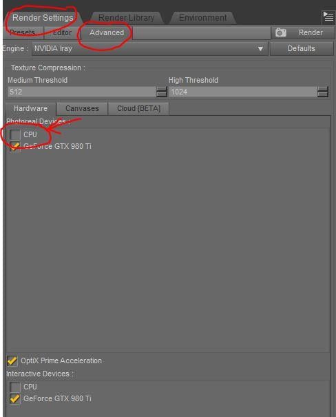

    The error message probably holds the solution.
    Go to your render settings, and select the "advanced" tab. Make sure that in "Photoreal Devices",  "CPU" is ticked. In my screenshot it's unticked, because the nVidea card is faster without the CPU. But if you have no device ticked at all (neither CPU nor GPU), then Iray doesn't know where to render.
    488 x 605 - 30K
    Post edited by BeeMKay on
  • Thank you, Bee - that was it! I HAD CPU checked at one time, but I guess I had inadvertantly unchecked it at some point. I was afraid that it was a conflict somewhere... Thanks again!
