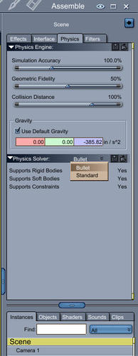

If you're using C8, or the 8.5 beta,. there should be an option to use the old "Standard" carrara physics engine, or Bullet,
In the Scene Physics tab... pic
The "standard" physics engine, only supports Rigid body physics,.
Bullet is still being developed, but has support for Rigid body, Soft body, and constraints
