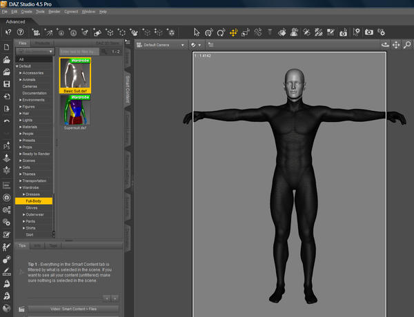

I am using DS4.5.1.6 and Basic Supertsuit pictured below which I just tested on Genesiis with M5 shape morph. When I chagne the shape of Genesis the Suit follows.

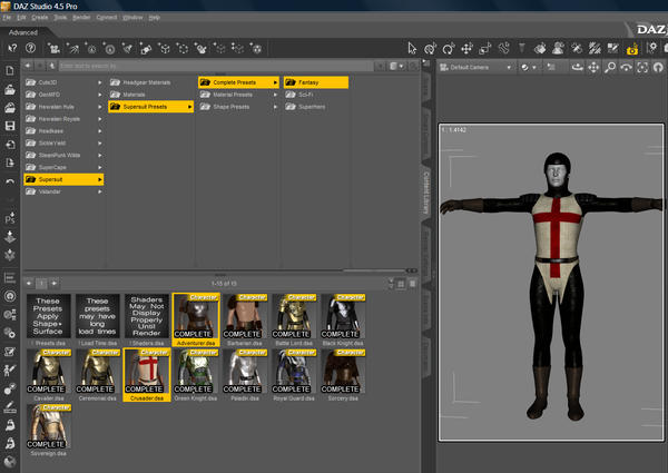

Have you looked in your Content Library for the Shaping Presets as shown below.
The Basic is just that Basic but if you use the •Supersuit (.DSF) then you will be able to adjust the suit as you want.
