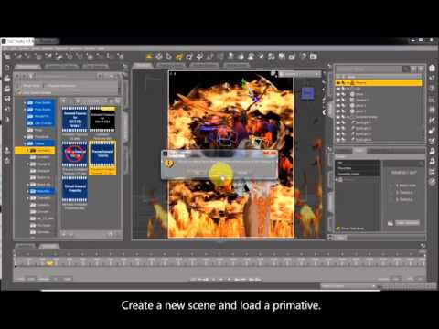

    What about Animated Textures Script Pro for Daz Studio 3 & 4
    http://www.daz3d.com/animated-textures-script-pro-for-daz-studio-3-4
    There is a demo of it on:

    To use any of the animated textures tools (I know of two at DAZ, and a similar one at the Rendo site, and one at the mentioned mcasual site - find him in the freebies forum, he's got all kinds of cool stuff!), you usually have to first produce a series of sequentially numbered images in a folder from the original video stream you choose to use. Most video editors can produce/export an 'image series' in a folder, and that's what you want - jpg or png images are fine. Most video editors will probably number the frames in a useable way for the tool you're using.
    Each animated texture tool uses a similar approach:
    To start simple, we'd do a single frame render with a picture on your TV screen - assuming you have a scene you like with a TV in it...:
     - make a simple flat plane in your Daz Studio scene
     - adjust the width/height to match your TV aspect ratio (usually 4x3 or 16x9). The actual pixels/numbers don't matter as long as the ratio is correct.
     - move, scale, rotate that plane to just cover the TV screen
     - instead of assigning the plane a color or shiny-ness, etc. you assign it your image - diffuse channel, 100% diffuse and 100% ambient I believe.
     - render the image from your chosen camera/viewpoint and the TV screen should appear to have the image.
    These animation tools simply map a different (sequential) image for each frame to your plane... or what ever you tell the tool you use to map it to (you could map video to a person's skin, or a cube, or ... for cool effects!)
    These animated texture tools add to the main Daz Studio animation timeline in concert with your existing animation elements on that timeline (e.g. animate2 w aniblocks), so it all comes together as you'd expect in each frame.
    I don't think you can make an aniblock that captures the entire video-mapping scheme, but these tools can and do work in concert with each other - and coordinate/merge all of the animation elements on the main Daz Studio timeline for rendering.
    The other option is to do the green-screen thing and make the TV screen in your animation green-screen green, 100% ambient, render your movie, and use a good video tool to map the video on to that screen. Most basic video editors can do this now. This presumes that the camera shots are static, otherwise this gets exponentially more interesting (mapping a video to a moving item.). There are other ways to render masks and the like but it's pretty much doing the same green-screen thing.

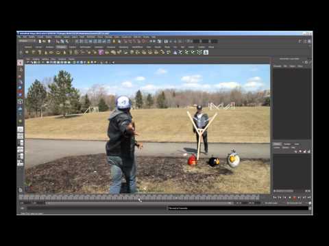

  • Heres clipp of angry birds on how they did it, they use autodesk - i dont like auto desk and love it if ANIMATED TEXTURES allows us all to do this
         start at frame 9.35 - this is waht im hoping Animted textures allows me too do - them remove the video footage and export the animation too Element 3d, correct tones to fit video then after affects for masking out things
    Sorry for bombardiing you all - but like i say its extremely hard trying to explain in teaxt exactly what im trying to do so hopefully clip will help you all understand what im trying to ask and just hoprfully animated tetures allows me to do this

    update: a quick check of DAZ' animated textures Pro, has a script icon "Preview animated textures ON" and one for 'OFF'. The 'ON' version pops up a message indicating that the video image sequence files need to be located in a certain folder/heirarchy to work as expected (witth a button to enable that function), so it may be a good indication that what you are looking for can be done with that tool.
    With that discovery, I would bet the product docs include some mention of that capability and its limits...
    --ms
    eta: It looks like there are no docs with the Pro version, and only a more basic PDF with the first  (lite) version that doesn't seem to have that capability, but the actual product page (pro) implies that there is some sort of previewing capability. You can see the mentioned script interfaces mentioned above on that page.
