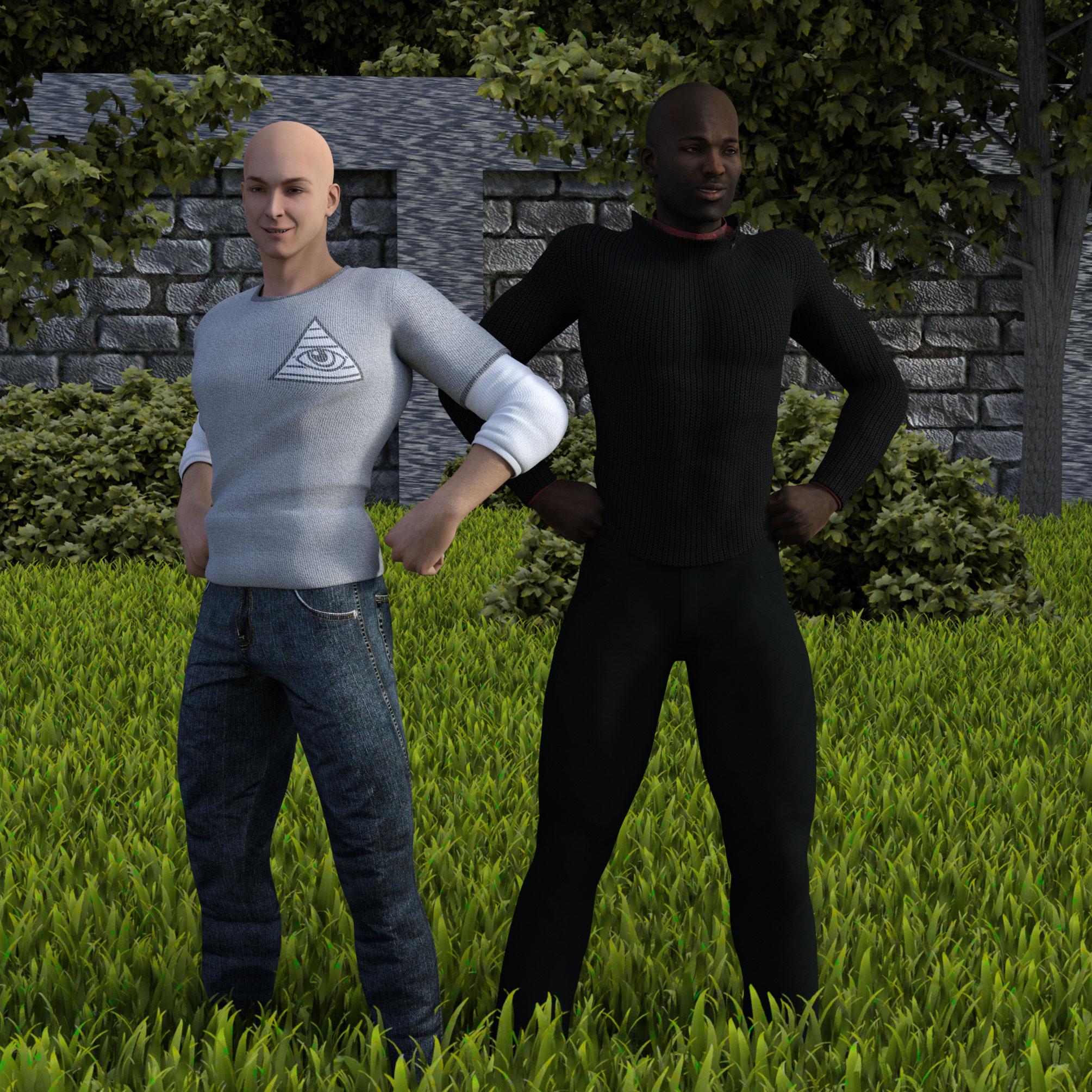

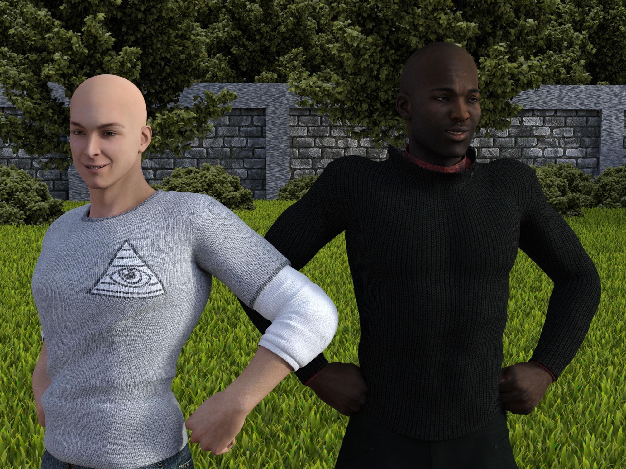

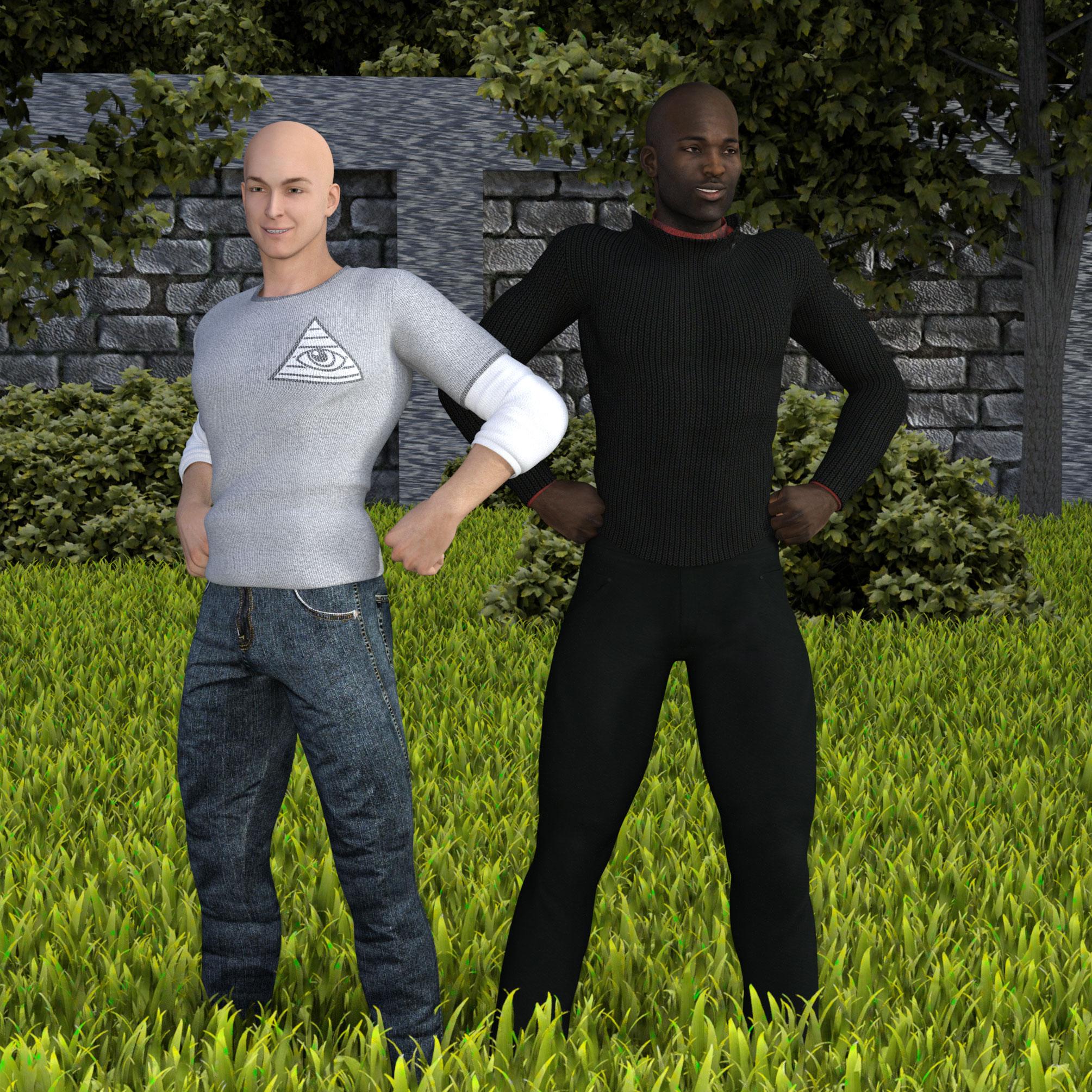

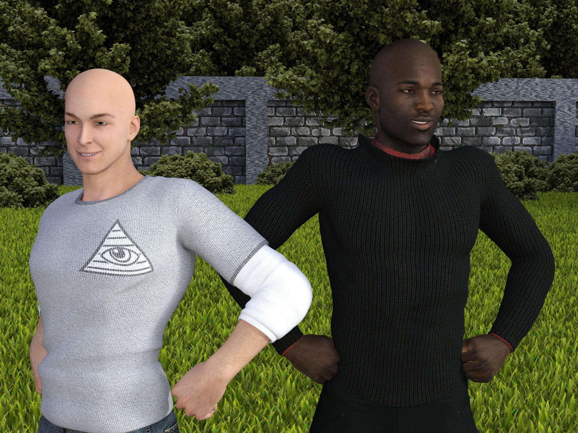

    Here are some render examples with and without headlamp for the camera:
    Headlight on:
    No Headlamp, HDRI only:
    As you can see, the default headlight washes out the shadows. As Tobor pointed out, you can use the headlamp as a fill light, but the default usually ruins the setting when you are using pre-made sets.
    In the closeup, you can see the difference even better, and the skin loses a lot of details due to too much light.
    No headlamp:
    2009 x 2009 - 1M
    2009 x 2009 - 940K
    2009 x 1506 - 807K
    2009 x 1506 - 768K
