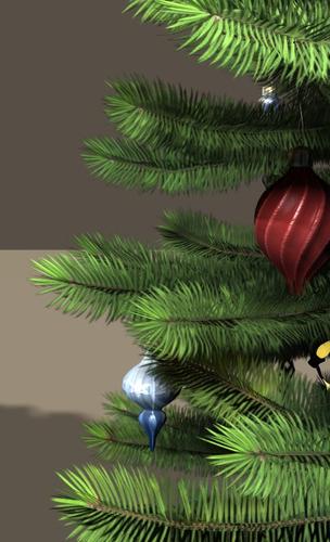

    No idea, don't know what billboards are. But i agree, using geometry would probably be a gigantic task. In any case it's very detailed and looks very good so I don't complain... :)
    I've attached a close up in case that may reveal something:
    490 x 806 - 76K

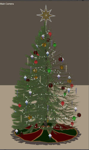

    Does it change anything if you switch preview mode (OpenGL - SreeD or visa-versa)? I have seen that before with transparencies. I assume it is not showing up in the render (those lower images are finished renders, right)?
    Well now that you mention it - I've just installed Poser 8 and PP 2012 in Win 7 - 64. In Poser 8 and PP 2012 - 32 the preview only works with SreeD, so I set them to use that. It seems however that this setting also affects PP 2012 - 64 (which I'm using here). I've now set it back to OpenGL, and this is how the preview looks now, in PP 2012 - 64. No difference in the rendered scene though, as far as I can see.
    And yes, the two lower pics of the first three I posted are renders.
    488 x 815 - 93K

    And looking at the picture you posted, they appear to be billboards to simulate the foliage (as lordvicore indicated). The foliage follows a similar path which would usually indicate a mapped transparency on a flat plane. Usually easier to tell if you observe it in the material room.

    Looking at that again, it does appear to be made out of billboards... if you look on the left side some of the planes are tilted slightly to and fro.
    My amateur guess is that the preview mode does not see the light interacting "properly" and perceives the whole part as transparent.

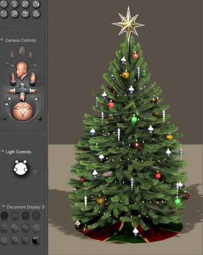

  • TaozTaoz Posts: 10,377
    araneldon said:
    Hey, that seemed to fix it. I checked Normals Forwards for all the needle material groups I could find, and this is how it looks now, with symmetrical lights. Thanks! :)
    643 x 805 - 104K

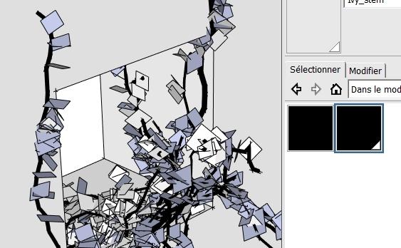

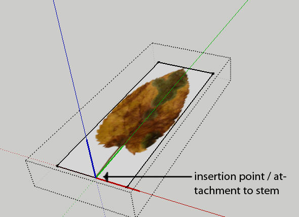

    Maybe I had that backwards... I forget if it is black or white that is transpartent, I've only made a few parts that were transparancies... but yeah, thats what they look like... I also noticed that if you look at the ground in the preveiw image the shadows on the floor are all there... BUT... for squarish/rectangular objects.
    PS... here are some images from a thread at another site's forums that I was recently following, they sort of show how a leaf would be handled...
    563 x 348 - 113K
    590 x 428 - 90K

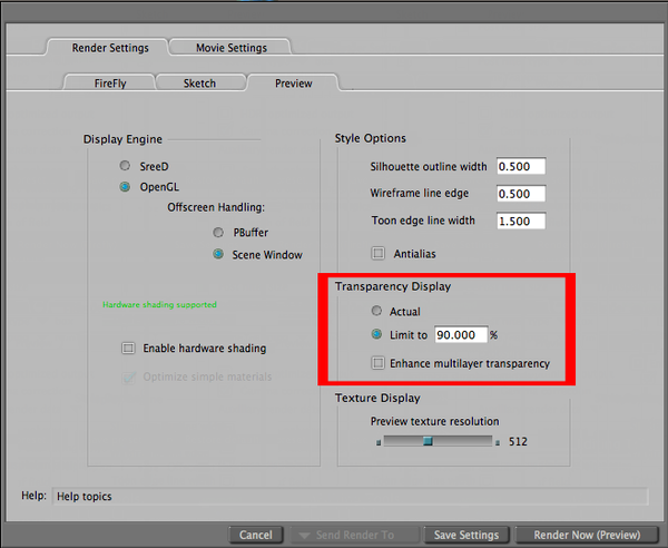

    At this point I don't know if this info is relevant or useful anymore, but I found some info in one of my Poser books... basically go to the render settings window and click the preview tab, in the next window and in the "transparency display" section you can try fiddling with those settings to see if it helps your situation any.
    I haven't tried fiddling with these settings yet myself... Sorry if you know about this already or is this is useless.
    658 x 540 - 102K
    This setting doesn't seem to have any effect on the tree in the preview. But how the preview looks doesn't mattter so much - the real problem was with the render, but that has been solved. But thanks anyway! :)
