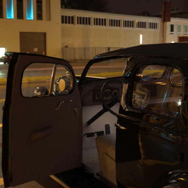

Here's a quick set up....
The lighting is an HDRI and two point lights.

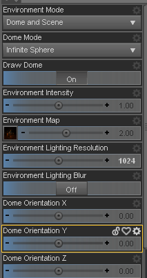

The first image is the Dome/Environment settings.

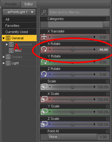

The next two are the point light under the dash.

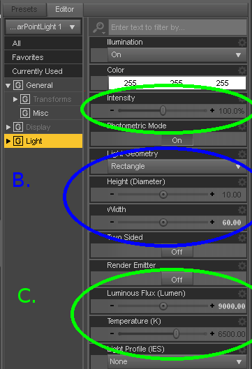

A. Due to the way Studio has its world coordinate system set up, lights load a little strangely. It works fine for point/spherical lights, but if you change the geometry (see B) then you need to rotate the light to put the emitting part pointing in the direction you want (in this case down).
B. You can set the geometry for a point light, in this case I chose a rectangular emitter, with the 'long' part of it running parallel to the width of the dash. I also positioned it slightly below the dash and turned 'Render emitter' OFF (that will hide the 'bulb'). The units for the dimensions are centimeters...
C. Control the intensity with the Luminous Flux, not the intensity slider. In this case, the default of 1500 was fine at the original default load of the light, but setting the geometry made it too low. I increased the length of one of the sides of the rectangle, so I upped the value of the luminous flux by the same factor (increase both length and width, multiply the factors and use that for how much to increase the light...it is tied to the area of the emitter).

What does the Dome do (If drawing it is a performance hit, I'll have to be careful)? Also, what effect does Environment Map have on the scene?
Thanks for telling me to turn Render Emitter off as in one attempt it did render! I was afraid to try that setting as I didn't know if it would still produce light. I'll set Luminous Flux, then as that is how I think anyway.
Scene only will use only the lights you add...photometric or mesh lights. That will disable the HDRI/global lighting.
If everything was translucent, it sounds as if the 3Delight shaders were being used/not converted on the fly, properly. It's better (and usually faster) to use an Iray preset or manually select all the surfaces and apply the Daz Iray Uber shader.
The dome is Iray's inbuilt 'skydome'. The environment map that is loaded to it is used to calculate 'global lighting'/image based lighting. There's no penalty for having Draw Dome ON. If not using a full environment set, it does provide (with a sufficiently large resolution image) a way to provide a background for your scene, *sufficiently large = pretty much any Hdri 8000 pixels wide or larger.
