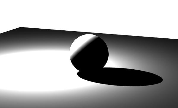

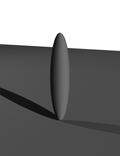

    You've got me mystified, guys. Which shader lights are you talking about? If it's shader mixer lights, they do cast shadows for me... At least they did in DS3... Now you've spooked me, I fired up DS4,set up a boring test scene and created a distant light and a spot light in the shader mixer. Both lights cast both DSM and raytraced shadows just fine.
    Area lights also cast shadows just fine in DS4, at least those from IG's Photo Studio LE freebie.
    Did I misunderstand what lights you were referring to?
