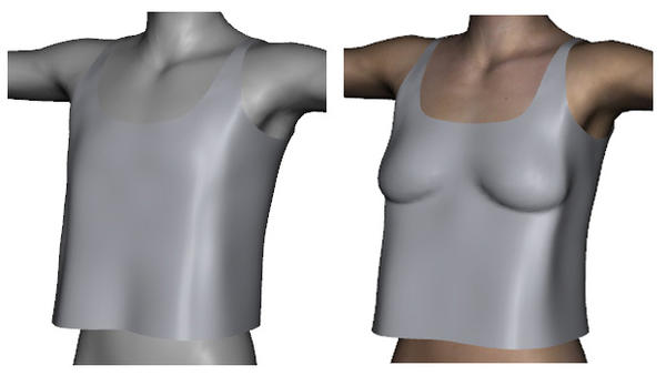

    Apologies if I have not explained the problem clearly enough. I have now molded the top more closely to the zeroed Genesis figure but still leaving the front draping loosely - see left image which is before the transfer facility is used. The right image has gone through the transfer facility process and had smoothing applied (no smoothing produces poke through) and has been applied to a basic Genesis female shape. This shows that the drape effect is marred by the material conforming to the lower curve of the breasts which is what I am trying to avoid.
    Grateful for any help in producing the desired effect.

    DS can't know that you modelled that as if draped over breasts, so when you set the female morph it will adjust the shape to keep the clothes in the same relative position with respect to the new shape as they were with respect to the original. What you should do is model it to fit the base shape, then create a custom morph (with the desired draping) for the female shape(s) you wish to use.

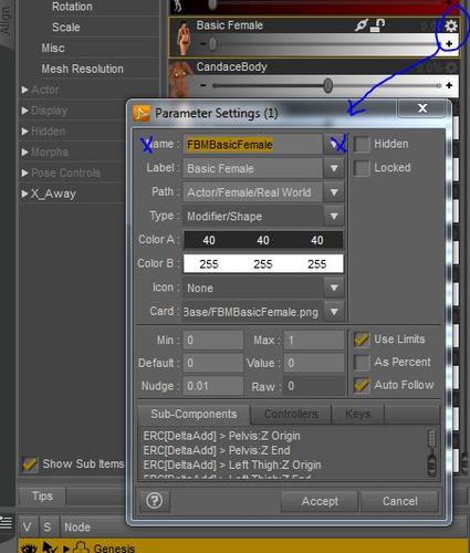

    You'd make your clothing so it would fit to the base Genesis, without any account of breasts, and a reshaped (but without adding any extra mesh) version that fitted over the female shape as you wish. Then after turning the base shape into a piece of conforming clothing you load the modified shape with Morph Loader pro, setting the name to FBMBasicFemale for the Basic Female morph. DS will then use the shape when you dial Basic Female up Genesis, without adding any additional distortions as in your earlier go. To get the right name to use for an imported morph you need to click the little gear on the slider, select Parameter Settings from the menu, and then look in the Name field (the Parameters and so on panes show the label, which is usually different - for a morph to auto-follow the Genesis morph the names must match exactly).
