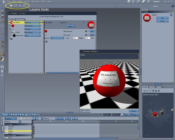

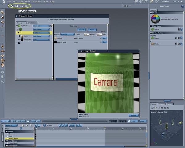

    HI Heavy D :)
    You can use the Layers shader tools to create a Bottle label,
    no need for UV unwrapping.
    You draw the appropriately shaped layer for your image (label) directly onto the model in the shader preview window,.
    you can resize it by dragging the points.
    You can use it to place Stickers or logos, or use it in the Alpha Channel to create a hole.
    800 x 600 - 39K
    1280 x 1024 - 221K
    1280 x 1024 - 167K
