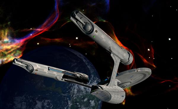

    Here's a new render that better shows what I did.

  • wancowwancow Posts: 2,708
    here's another I just did
    965 x 591 - 315K

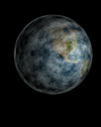

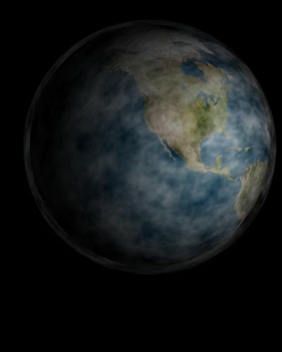

    Here's one...
    Inner sphere...texture mapped
    Outer...a volume shader applied (I'll post the ShaderMixer network later...)
    800 x 1000 - 242K

    mjc1016 said:
    Here's one...
    SUWEEEET!!! I'll be anxiously awaiting that one.

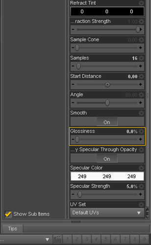

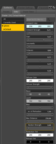

    Here's the network....hopefully the forum will keep the images in order...
    330 x 535 - 17K
    332 x 848 - 26K
    1000 x 986 - 85K
    Post edited by mjc1016 on

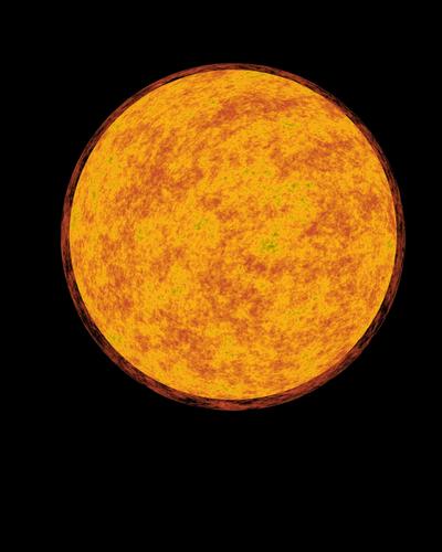

    The Ambient Strength setting can provide some very interesting effects.
    The Gain setting is another fun one to play with.
    Here's a render with it set at 30%, as opposed to the 5% in the first render...
    The second one is the same shader, with Ambient color set to an orange at 100% and the sphere color yellow at 100% Ambient at the same color as the Diffuse...only a specular light is lighting this scene...
    800 x 1000 - 336K
    800 x 1000 - 250K

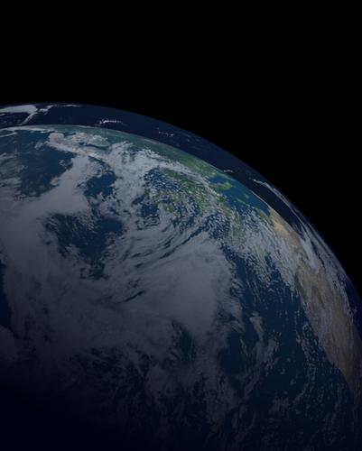

  • niccipbniccipb Posts: 483
    Hi...
    Lots of great tips here... :)
    And if I might add, consider the distance of the planet from the camera... If the planet, earth in this case, is far from the camera, you can just use a single sphere with a combined texture map, ie: surface and clouds... from great distances in space, the atmosphere layer of a planet is not visible... but the closer you get, the more prominent and fuzzier the atomosphere becomes... also as you look towards the sun horizon line, the brighter it becomes...
    Another important thing for closer planetary views is to have good maps, color, bump, displacement, specularity, cloud, night lighting... and they can be found through alot of sources on the web...
    A good source for HiRes maps of the earth is from NASA Visable Earth, they are very large, but can be re-sized if needed...
    Adjusting the surface settings of the cloud and atmosphere layers goes along way in creating a more realistic planet... diffuse, spec, bump, displacement...
    In the image below I used a primative sphere for the planet and then geometry shells for the clouds and atmosphere... done in DS 4.5 and rendered with 3Delight
    I added bump, displacement and specularity maps to the planet surface... texture, transparency and displacement maps for the cloud layer... and then applied UberSurface to the atmosphere surface, turning on velvet, subsurface and translucency, and changed the opacity color to a light blue...
    I used a single distant light with raytraced shadows and set the shadow softness to 30%, so that the clouds shadows would not be harsh... also the horizon line shadow and terrain shadows would blur...
    The sun is pointed just off the west coast of Africa, and you can see the blur of the horizon line just about the center of the planet... most of the light that is wrapping around the side of the planet is being bounced off of the cloud and atmosphere layers... if the camera was further away, you would want a harder shadow on the horizon...
    A little bit of postwork can soften some of the hard lines, especially the sunside edge of the atmoshere layer...
    Good luck, can't wait to see how you do... :)
    1500 x 1500 - 324K
