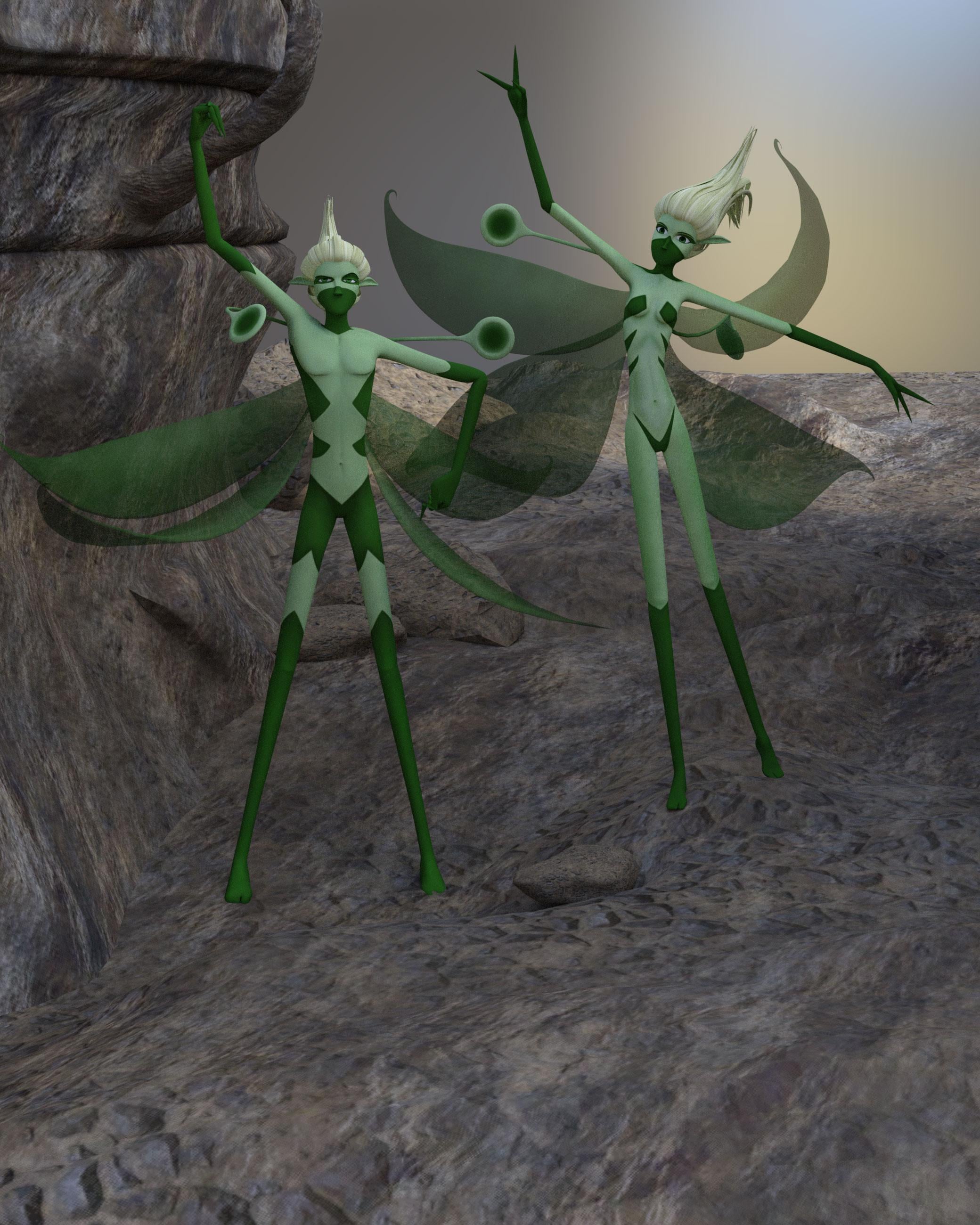

    The Pixies work fine in DS - here's a render straight out of the box, using Cookie&Chip poses. But the wings and stuff works fine, jointwise.

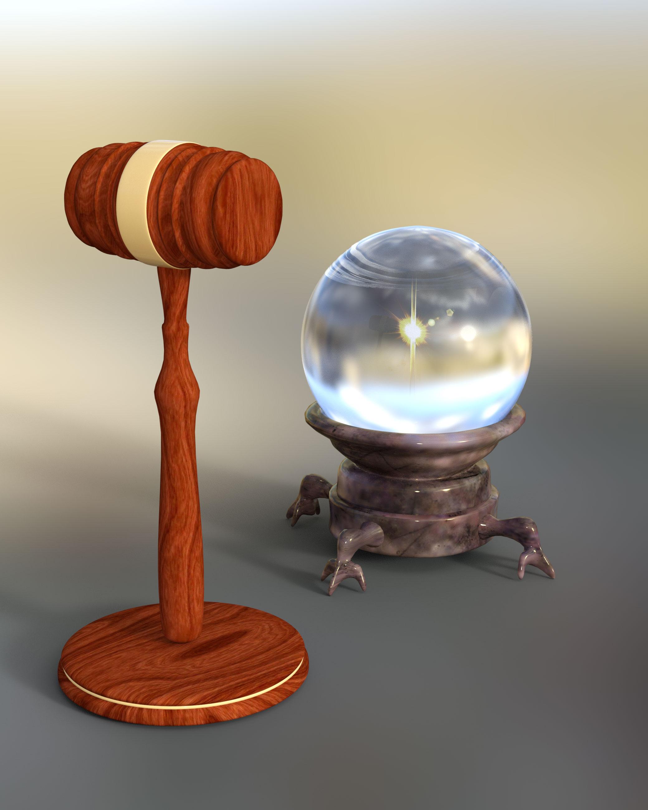

    EDIT: The Gaffel works fine. The Magic Ball has a missing file (reporting this to CS at the moment), so I had to replace the surfacd with Iray glass shader, but the rest of the image below is straight out of the box with no changes to surfaces, etc.

    @BeeMKay Thank you! :D  It's great to know they work in Daz! I love the renders by the way. The pixies are so adorable!
