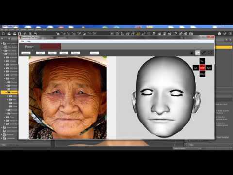

    I just did a search on "One Click" and found that thread.  So, HS is developing a similar to Facegen type of software that you don't have to pick points.  That is very interesting.  After reading that thread, it doesn't sound like One Click will help much over Facegen except for the auto texture placement and dropping the point placement step.  I am very curious to see the results.  I might give it a try if there is a really good price break for current HS users.  I like HS when it works.  It's just such a buggy program.  It's funny that Abalone mentions "you can't screw up."  I realize that there is a lot of user error in HS.  But, that doesn't excuse the fact that the program itself is very crash prone and can be hard to navigate.  If the new One Click is stable, that will certainly be an upgrade.  But, I think they will have a problem by not offering the auto and hi res textures capability of FG.  Those ready made whole body textures are a huge time saver even without auto placement.

    One-Click is a simpler to use with fewer bugs version of Headshop. I had Faceshop 7.x at one time but due to having to pay full upgrade price to go to Faceshop 9 and owning FaceGen Pro 1.9 I decided not to buy it. However the results from One Clink look bug free enough and good enough and cheap enough that I will buy One Click. It remains to be seen which results I will prefer - One Click's or FaceGen's. I'm pretty happy with FaceGen when I can get a good enough picture & place the dots precisely - even with frontal only pictures.

    Good news: OneClick still has all the tweakable points if you need to tweak something. It also still has the profile tool as well.
