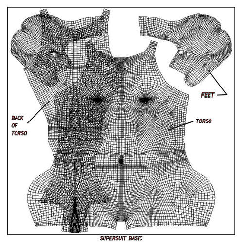

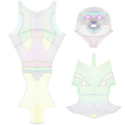

    I’m not sure whether or not you all ready know this, but I’m going tell you anyhow. Both the Supersuit and the basic suit use the same UV map, problem in that is the Supersuits torso has a back surface defined and the basic suit does not. I have no idea how this could be fixed. Both the front and back of the basic suit need to be on the same map, but there isn’t enough room.
    Redistributing shouldn’t be a problem as the map is of no use without the object. Also you only need to supply a new map for the torso as the hands, arms, legs, and feet are fine.
