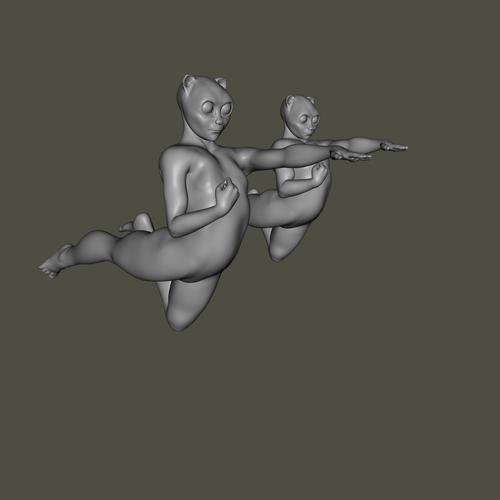

    Well the best I can do for now until I get some help on the joints is to create a "Properties" preset.
    In the newer presets seems that saving as a shaping does not include the ability to save scaling. So from trial and error found that the "Properties" preset has TABS.
    Tab one is the shaping info to be saved,
    Tab two is the pose properties which includes the scaling info I needed and
    Tab three is for surfaces, which I don't need.
    For those that say "use the Character Preset" it doesn't work as I need. It too leaves out the scaling so that does me little good. Plus it takes FOREVER for it to save and to load.
    Using the Properties preset works fast and perfectly for this character's look.
    This preset makes use of my Medium sized Fuzzy morph and then a bunch of the propagation morphs included with Genesis as well as scaling. Looks just as I want it to look. Wears the clothing fine and poses just fabulously! So that's what I got for now.

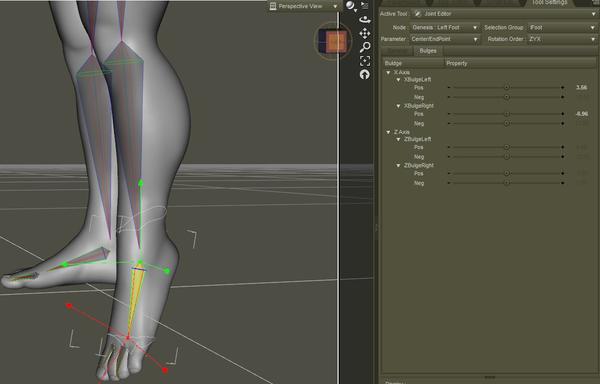

    Looks like I may have found a solution to my joint issue so might not have to rely on the duf file I created to get the little guy working correctly. In the Joint Editor, when you click on a bone another tab becomes active. In that tab are BULGE parameter dials and low and behold the feet now look good when bent any way I can imagine. So going to go over the rest of the body and fix what needs fixing and ERC Freeze it and see what happens.
    Fingers crossed.
    1189 x 760 - 78K

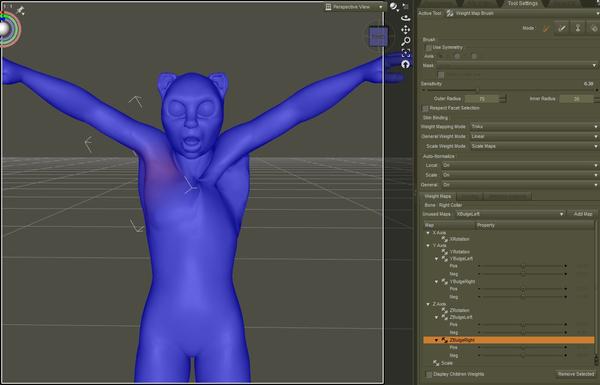

    Done. There are a couple of areas to be aware of. The Abdomen 01 is not perfect and there was no way to fix it, even tried to do a fix in ZBrush and that was not good either. Most poses won't give it away but it is there and I'm aware of it. Shoulders all the way up cause the pec to pull all the way up to a point. No way to fix that either. I might try again but still most poses won't give that away either.

    I was thinking about the pec issue. I think I remember having that happen while I was developing the Bruno morphs. Might take some back and forths between ZBrush and DS but I THINK it's totally fixable. Not sure what to do about the abdomen 01 bend. Bent back the lower belly pops out and bent forward the navel sort of collapses into the gut. I'll keep banging my head until I figure it out. Not releasing him until the big big update to LAMH hits as I plan on doing the full furred version for the little guy above. Not sure if that will auto fit the medium and tall versions though. We shall see how that plays out.

    Took a different route and got the issues resolved. Thanks mostly to Nicci & Richard H. for their excellent help and patience.
