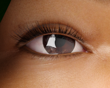

    I am still strugling with eyes, but I have found that while working with textures, the PBR Specular/Glosiness Base Mixing behaves better than the Metallicity/R. I prefer to turn off translucency as eyes are a small area, also I always turn off Top Coat. Another important thing is iRay expects textures with a neutral gamma or the render will look wrong.
    I'd love to know what others are doing.
    450 x 360 - 281K
