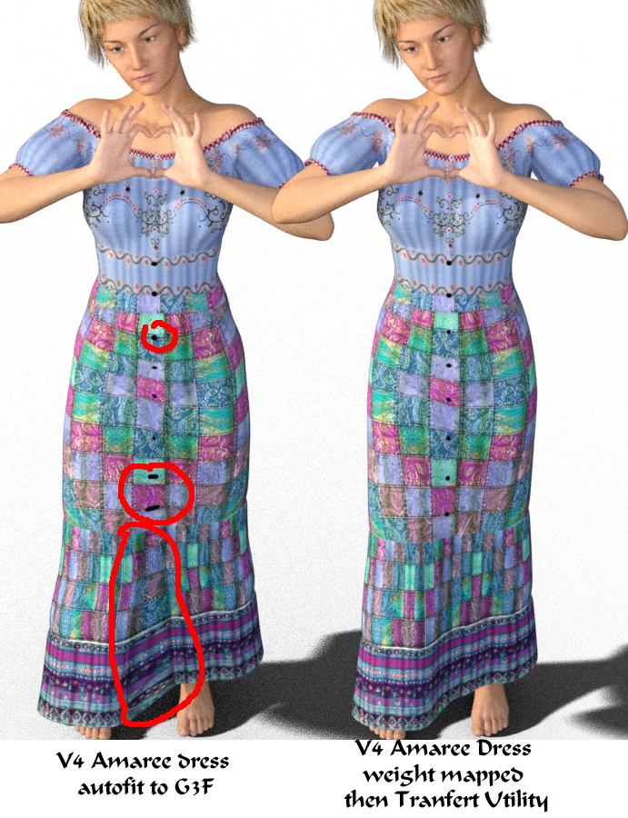

    mtl1 thanks for sharing that information, it got me thinking...
    And I may have found something.
    Load a V4 dress, weight-map (edit/figure/rigging) and then run it through Tranfer Utility (source G3F) and got interesting results.
    See image
    691 x 900 - 851K
    Post edited by xmasrose on
  • mtl1mtl1 Posts: 1,508
    See image
    Hmmmm. Unfortunately, that didn't work for my V3 stuff :(

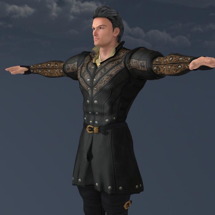

    Are you talking about the crotch distortion when the figure is posed?
    Go in with the weight map editor and smooth the weight maps for the thigh bones around the boundries of the weights.
    I have a problem in the crotch area with a M4 clothing item fitted to G2M.
    This is a great suggestion, but where do I find the weight map editor and how do I use it?
    700 x 700 - 208K
    Post edited by dracorn on
