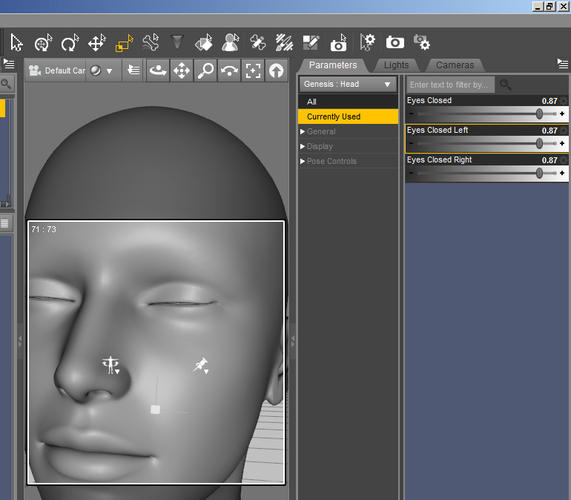

This is what I get...

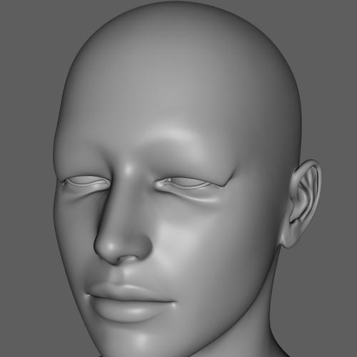

EyesClosed Pose Control on the DEFAULT GENESIS
at the risk of repeating myself:
THIS MORPH IS BROKEN

Mine seems to work OK, image below on the base Genesis using the Eyes Closed morph.
Check and see what the default values for Eyelids top/bottom up and down are...you may have saved something that changed those. They will 'assist' the closed morph.
What I'm thinking is that I need to re-install Genesis... :(
I've searched and searched for what I might have changed or installed that might cause this, but I'm finding nothing at all... The dial pulls the brow down, which it absolutely should not do. Something got messed up somehow.

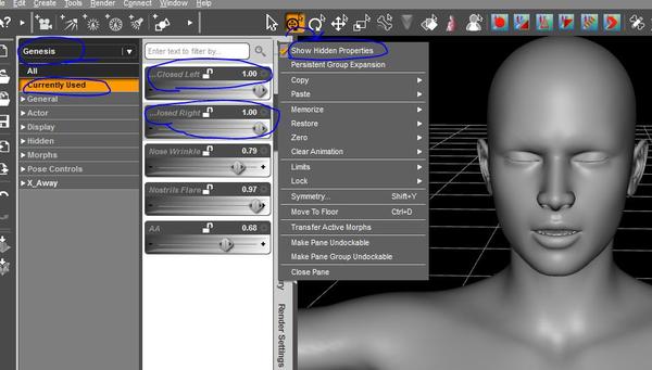

but,, if I were you,, load defautl genesis again,, then,
after apply the poze controller "Eyes close" to full, select "genesis root" in scene tab,
use option "show hidden properties". and check currently used,,in parameter tab.
because,, if some hide morph value has been changed
you can check them.usually .
if I use close eyes about efault genesis, just two PHM parameter changed.
so if other PHM or MCM has changed,, it cause the problem.
anyway,, I hope,, you can remove the problem.
