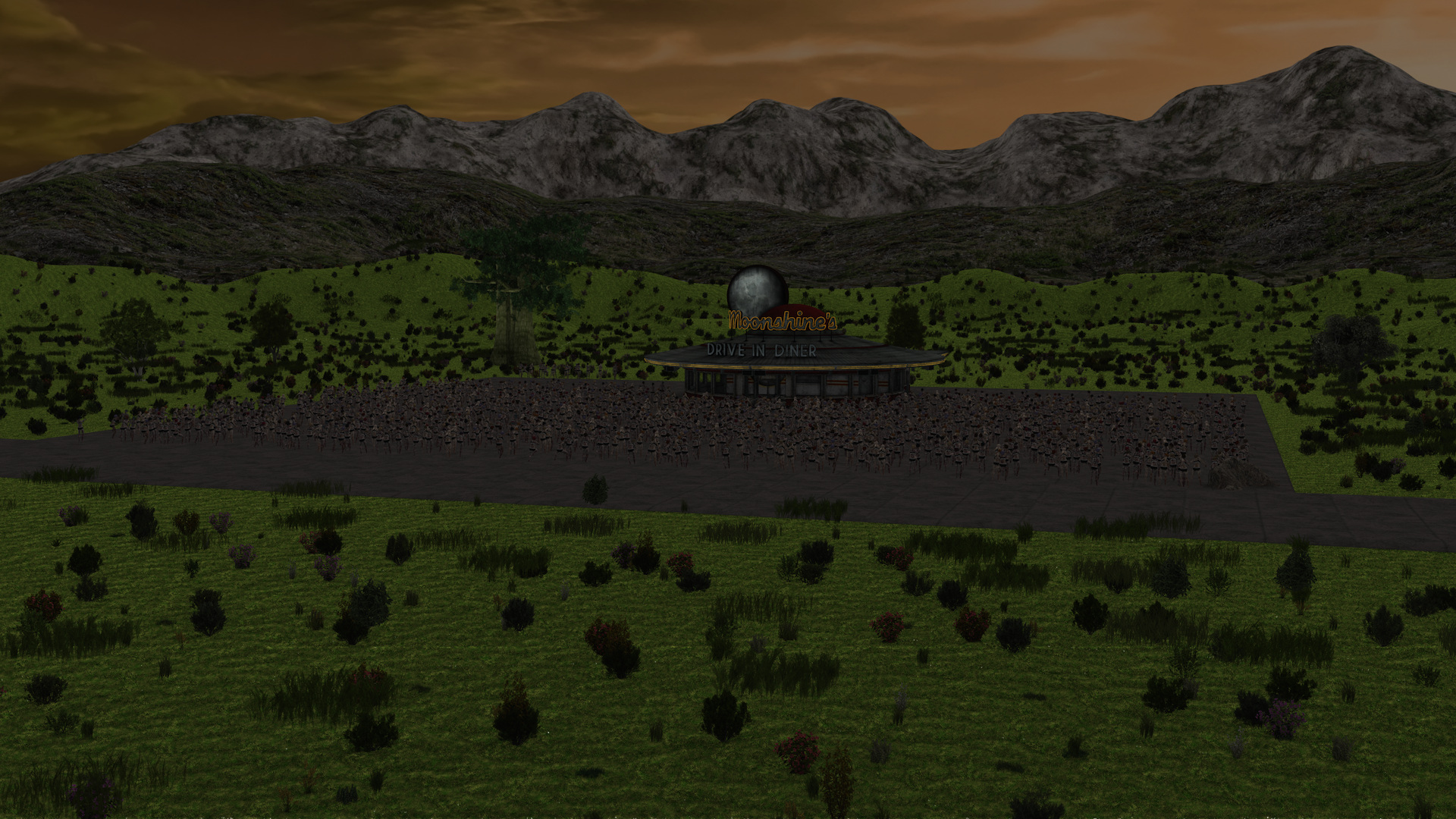

    I promised a Zombie Hoard and I am delivering, after a few false starts and a little head banging, really bad words and Real Life setting its bottom on my keyboard and demanding to be dealt with.
    The scenes below has 1515 zombies. Okay, I know they look like Genesis 3 Females, with Lucille Zombie and Lavinia Vampire for Genesis 3 Female skins and in basic undies, but your all artists use your imagination. It is a work in progress and with a change of clothes, they will look the part.
    So how about render times, I got those.
    Stats first:
    The base of the environment is the Original TerraDome system from RDNA. I am using Zone1, two Zone2 sections , two Zone3 and Sky-dome; at 300% of scale. The surfaces are using the original texture images, but recreated as the RDL shaders. There is no flora in this WIP, but will be adding some. Lighting is supplied by DimensionTheory's Luminance HDRIs for DAZ Studio with the intensity reduced, to get that almost dark dusky feel to the image. (I do have another set done with AoA's Lights)
    The big set piece is Moonshine's Diner, with Fallen Textures, I added the inner wall but it need to have some grime thrown on it. I didn't use the Fallen set, due an issue with the Texture. (If someone could double check that, I will put in a Bug Report on it.) The roof sign lights and the neon rim ring lights, I recreated the Surfaces as Surface Lights with the Shader Mixer. All Renders are with 3Delight, at 1920x1080, on an i5 4670K with 32GB.
    Scene Items :
    Nodes : 5,185
    Lights : 2
    Cameras : 12
    World-Space Modifiers : 0
    Scene Geometry : Active / Base
    Total Vertices : 1,872,557 / 1,327,164
    Total Triangles : 14,750 / 14,750
    Total Quads : 1,583,170 / 1,109,434
    Total Faces : 1,597,920 / 1,124,184
    Primary Selection :
    Label : Prine A 174cm
    Class : DzFigure
    Vertices : 17,418 / 17,418
    Triangles : 0 / 0
    Quads : 17,000 / 17,000
    Total Faces : 17,000 / 17,000
    You will notice that I have turned off the Sub-D, which reduces the active number faces from 68,000  to 17,000 per G3F.
    Total Rendering Time for 1500 Instances Plus+ Camera 6.png: 24 minutes 9.32 seconds
    Total Rendering Timefor 1500 Instances Plus+ Camera 2.png: 27 minutes 9.3 seconds
    Total Rendering Time for 1500 Instances Plus+ Camera overhead.png: 20 minutes 40.82 seconds
    So there you go, If anyone is interesting how I kept the Zombies out of the Diner, the Differences between UltraScatter and Instances Plus+, or want a few tips on how to deal with 1500 Zombies and all the other little things I learned along the way. I'll happily do that in a separate tread. But tell me today. Tonight at Midnight I start writing for NaNoWriMo.
    But I think this proves you can do a believeable Hoard of Zombies, Irate Potesters, or Adoring fans, with 15 to 20 Primes and a hundred or some instances of each and using 3Delight Render it in time for Lunch! Which I need to get to.

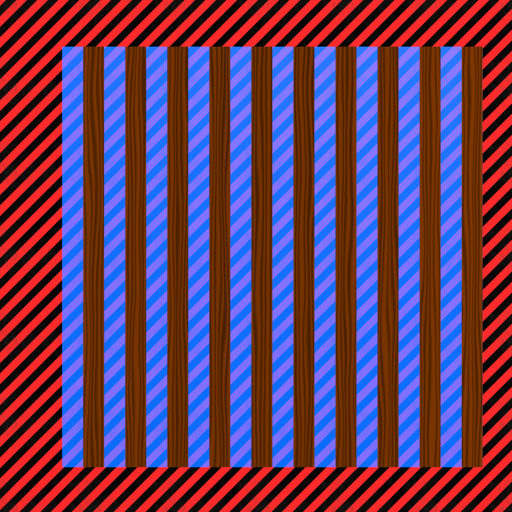

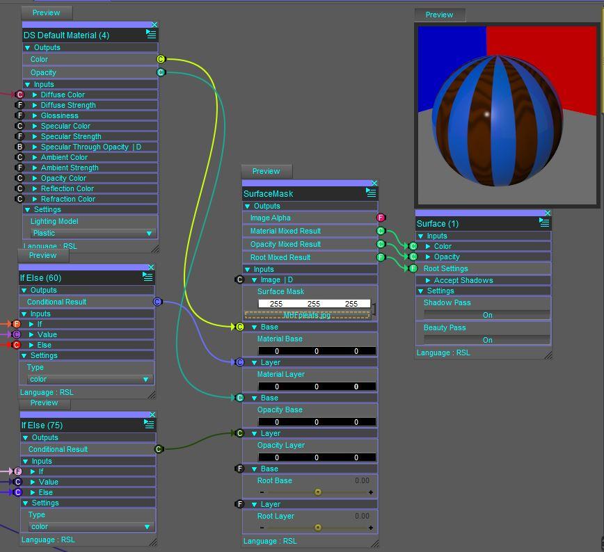

    I have created a RDL Root brick that sits between two DS Default Material Bricks and the Surface Brick which use a Mask Image to choose which Material is selected.
    I was thinking of all sorts of things it could be good for. You could have Metal and plastic. or Metal and Dirt. Shiny metal and rusted Metal. Each Surface supplies Material Color, Opacity and Root, they are Mixed in the Brick and come out according to the Mask. I'll do the Displacement Mixer soon. you can grab the SurfaceMask Brick. Trythis (Note: I'm trying to find a better place to share this from, please bear with me)
    The Sample here is of the "Wood" Shader which comes with Default Resources for Daz Studio and Digital Lite Design Latex Shaders (which uses AoA's SSS Shader.) I dropped the Opacity on the Latex shader so you could see each Material is fully controllable with in and independent from each other. have fun with it.
    Little Zombie WIP update: Yesterday I threw some Flora at the Zone1, which first required me to do a Little house keeping, Naming Cameras (Work North face or Shot Wide angel Parking lot); Resizing and repositioning the whole TerraDome set, moving the Diner sub-scene; and then I had to move the Zombies. I learned I had made a mistake, I failed to ensure that I have all that in order before I started adding Zombies or Orcs. The Plants are not an issue the Zombies were a different story all together.
    I also learned to Love and Loath UltraScatter (more on that later), as I learned a few more things about UltraScatter and it's Distribution Map
    This is a very Cool feature. After almost three hours, I had added 10,000 plants (shrubs, bushes, and a few flowers). And decided to use AoA's Grass Shader, seeing I am using 3Delight, I can get a fuzzy field. with some variation of height, clumping and other factors.
    I am in the process of dropping about 2500 instanced rocks of various sizes into the zone. So far so good. And I am thinking of seeing what would happen if were to add both sets fo Zombies in for a total of 3000 zombies?

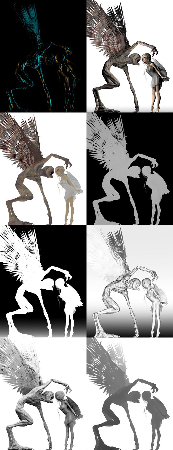

    But 3DL *IS* awesome! 3DL allowed me to author custom shaders (applied dynamically via scripts) to render out all my analysis passes:
    These analysis passes are then passed to illustrators (proprietary software) to be rendered in various styles using fractal algorithms:
    I simply could not accomplish this using Iray.

    I've thought about trying to adapt my workflow to utilize Iray, but it makes my little brain hurt lol. How about a version of 3DL that makes use of cudas?
