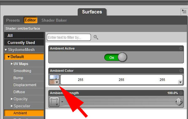

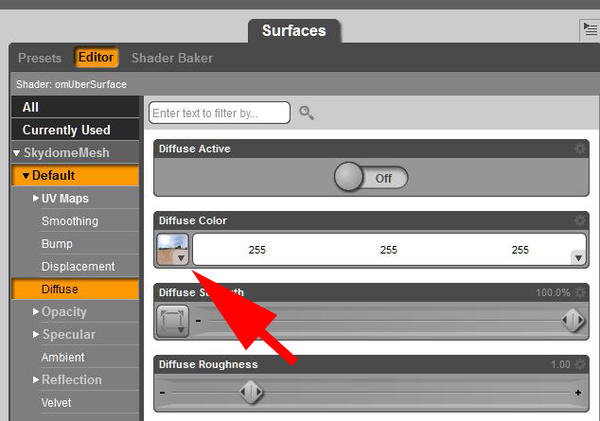

    You can also start with one of the Urban Recreation HDR environments, if you have those. It comes with a shadow catcher, which is nice. Once you have converted your HDR files to the correct format following DavidGB's directions, you go into the surfaces tab and change the diffuse and ambient image maps of the UR Skydomemesh to your highres JPEG image. Then change the image map on the UR UberEnvironment light to the lowres blurrred HDR TIFF image. Follow DavidGB's instructions for aligning the distant light in the UR environment to the new image you are using for lighting (his response to my question about the "cube" tip.) I did this process successfully with a couple HDR sets I downloaded from the HDRLabs site that DavidGB mentioned.
