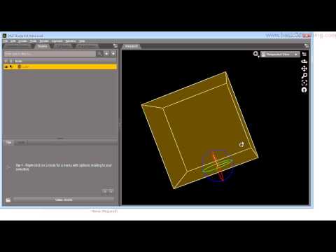

    Can you be a bit more specific? Which pose set are you having problems with? How do you apply the pose?
    Here's a short video about changing the rotation point, though it has a bit of advertisement in the beginning: https://www.youtube.com/watch?v=I78f5btO0jA
