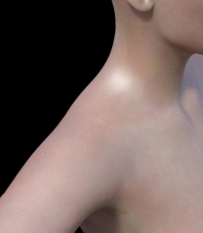

    I have similar shoulder and neck issues with EcVh0's G2F Iray shaders (same problem with several characters, this is V6). I've used them before (long ago) but not noticed it before now. Can it have anything to do with recent changes made to Iray in DS?
    811 x 930 - 370K
    Post edited by Taoz on
  • Design Anvil - Razor42Design Anvil - Razor42 Posts: 1,250
    edited October 2016
    @Taozen
    Cosmo71's issue seems to directly relate to the texture maps or material settings as the example he provided on the other thread was captured from the preview viewport and is also visible in an iray render.
    As far as the issue you are seeing.
    Do you see this issue with all lighting when using the shader settings? Have you tried resetting the render settings to default and testing for the issue? Is the issue apparent on g2f characters without using EcVh0's shaders with your current lighting and render settings?
    If you only see the issue when using the EcVh0's shaders and when using a variety of lighting setups as well as the default render settings. It would indicate there is an issue with the particular shaders and it's likely worth raising a ticket for the issue. Whether its to do with iray changes it's hard to say.
    It would be great if someone could confirm by checking that they also see the same issue when using the product first though.

  • TaozTaoz Posts: 10,367
    I have tried everything you mention above, always same results though it's easier to see with some light settings than with others. I've tried 2 other Iray shaders for G2, no problems with these, neither with the original 3DL textures/shaders under the same conditions.
