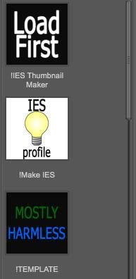

Unzip this zip file into any directory full of IES profiles. I'd suggest a sub-directory in Presets/Lighting. The only requirement is that the IES profiles have a .ies file extension (case in-sensitive).
That directory should now look like this in your Content Library (you probably need to refresh).

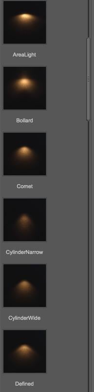

Load the scene labeled "Load First," then double click the light bulb. DAZ will perform a boat load of renders, but they're thumbnail sized so they'll run pretty fast. When it's all done refresh the folder again you should end up with something more like this. Holding SHIFT while double clicking the light bulb supresses the renders, but will still update the light profile scripts from the template (useful for when I release upgrades).
