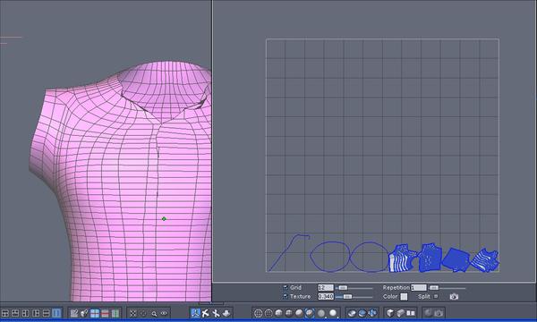

OK - so I have gone to uvmapping and selected the region for the shirt body...
I then selected cylindrical UVMapping (because it started with a cylinder...
I then saved the resultant area as a BMP...
What now???
Am I best doing it as a cylinder or as a flat surface???
How can I get the garment flattened out?

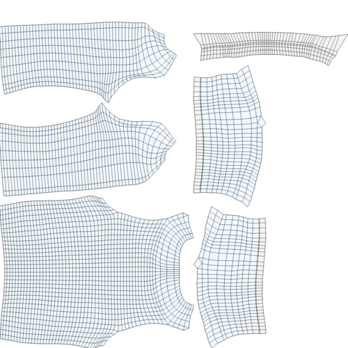

Here's a shot of the UV mapping I did for it...
I used Blender which allows you to make seams to split the item along. There are other programs with that ability too, but I don't think Hex is one of them. I find it one of the easiest methods of mapping around.
Yeah, it could use a little clean up to minimize stretching and even out some of the areas, but for a quick map it's fine. Also I wouldn't worry too much about it if there are any mesh edits planned. A map like this is fine for plain, solid color textures or to get an idea on how tiled ones would look. But as a 'final' map, I'd clean it up first.

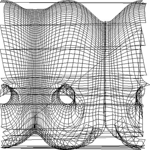

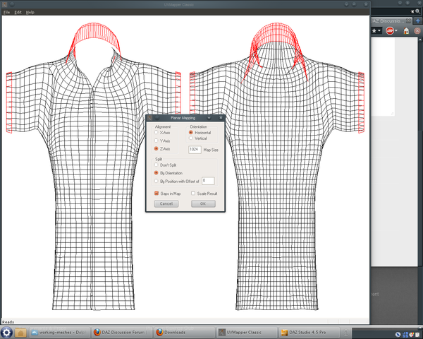

I've downloaded UVMapper - loaded the object file and the picture I got is as shown below
What am I supposed to do with THAT!
With UVMapper, the 'cleanest' result is Planar, Z axis alignment...

AS a texturer I have to say that the original UV map that MJC showed is the one I would choose to use. It reflects how a shirt would be put together in realy life, and thus would produce the best textures for it. Ithe UV grid lines are nice and clean, and thus wouldn't produce too much stretching or deformation of the material used to create any textures.

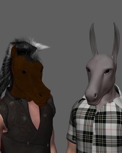

I've never needed to texture a shirt - I'm more into mechanical type modelling - but take for instance the plaid texture that tdrd wants to do. My gut feel is that I agree that the first one produced by mjc1016 is the one to go with. i would be inclined to stitch it together, then overlay the back and front so that the texture pattern would line up at the sides and not produce an ugly seam.
What approach would you take to get the plaid pattern to line up?
Well if you make a shirt for real, the parts that he has on his telmplat is how you would cut it out, so often Plaid doesn't match up on the semas. Me though I would play around with it while texturing, to try to get at least a horizontal match. Ie I would make a layer with a square swatch of the fabric, and then do test renders to see how the UV grid lines are matching up.
This is using a Fabricator preset.
It isn't too bad, and the big mismatch across the front is that the mesh itself actually dips that way. In addition to the UV being slightly skewed...The combination makes it a bit more 'off' than it should be...
With a little work on the UV it can be made to look pretty good.

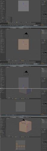

But...here's a quick run through.
When you first open Blender, it should load with a cube in the middle and if you look down at the bottom, there should be a little box saying Object. If you hit the 'A' key, that should select/deselect All..now if you click on the box, ith will b a drop-down menu. One of the items is Edit...click it. You are now in Edit mode. The options along the bottom have changed and so should the list of things on the left hand side...
In the middle of the various icons on the bottom, there is a series of three...the first should show a 'point' in a brighter color, the second a line and the third, a square. Select the line...that's for 'Edges'.
Now on the cube if you place your cursor along an edge and right click on it, you will select that edge.
Then, when you've selected the edge, look over on the left, you may need to scroll through but there will be a box, "Mark Seam"...click it. The edge will now be bright red. After you've marked that one, go ahead and select several more edges...thinking about how you would like the object to look when cut along those seams.
After you've selected and marked your seams, hit the A key (you may need to do it twice...but when everything is orange, you are set...). Then one the left, hit "Unwrap"...it's right above "Mark Seam". You'll be presented with several options (choose Unwrap as that's the automatic one).
Now, on the very bottom should be another pane...and a little box on the very far left...click on it...a drop down (well, in this case drop up?) will appear...choose the "UV/Image editor". This will turn that bottom pane into the editor window...you'll need to drag the separator bar up some or find a magnifying glass....

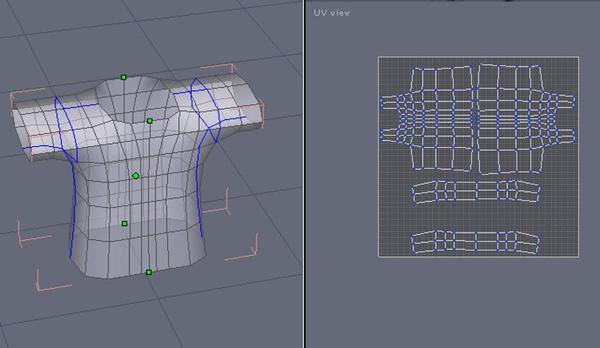

Hexagon is fully capable of doing what you want - although it has no idea of proportions and you will probably have to eyeball scale some parts to get the proportions correct. As for rotating and scaling, etc., once the unwrap is done and validated, you use the normal modelling tools to select and manipulate the UV's, just as if it was a mesh.
In this very quick and nasty example, I marked seams along the sides and around the arms, then from both sides of the neck to the seam around the arms - see the blue lines. Then I marked pins - see the green dots (ignore the centre green dot - that is not a pin, but the centre of the bounding box.)
The process is very simple - with the mesh selected, go to the UV & Paint tab, select the head icon. Mark the seams by selecting edges. In the properties panel, make sure "Seams" is showing and hit the + sign. Now mark the pins, make sure "Pins" is showing and hit the + sign.
Hit validate, then you can select faces, edges or verts on the UV grid and rotate, resize as needed.
Always better to do the UV mapping after the modelling is done and before smoothing - this makes it easier to identify and select edges. Once you are happy you can then add smoothing.
