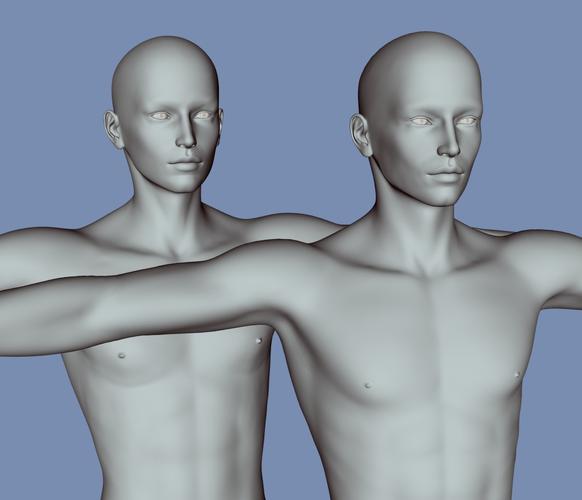

Here are a few comparisons. M4 is at the front. Note that I dialled the Michael 4 shape into Genesis before dialling the Gen X shape. I think you can see that in most cases the M4 has more modelling (although adding a texture will make this less noticeable), but sometimes the transfer can be a bit of an improvement.
Thanks for that HP, they look really well.

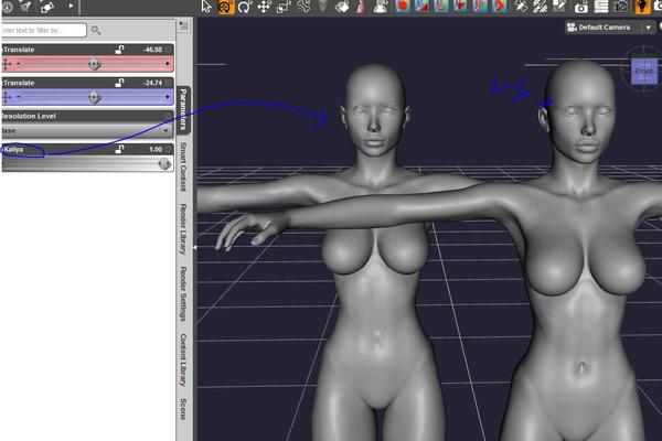

it is my Aliya for genesis which just transfered by transfer utility, and I did not tweak it yet.
(if I tweak around eye brow,, it will be more good,,,,)

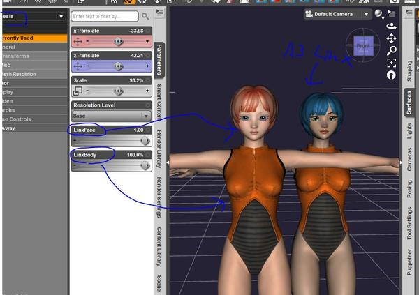

and one more pic .
as for me, when I transfer morphs ,, I keep it as new one FBM,of oneFHM
so if it need A3 or A4 or V4 or utopian etc,,I gather them as one.
then transfer.
(I know there is another problem,, but,, if I transfered separately each morphs,
I think each character JCM may not well transfered, so it is better, after transfer character,
make new JCM by my self and adjust about the shape for genesis.. if I need,,)
this is,, "A3 linx" transfer to genesis by (transfer utility and A3 shape for genesis)
about this case, I keep as head morph and, only body part morph,(not FBM)
as usuall genesis scale. so need to change scale. but I need not change A3 shape morph.for genesis.
(It is imvolved in my new morphs already)
nyoko hair B is original hair for A3
just parented it to genesis linx. (forward) .
I have no tool to change linx material to genesis still, (though I know the tool,,)
apply other A4 texture to genesis, and apply A3 texture to A3 linx.
(original linx texture has so big animetic eye, if apply it, the effect of transfer may not understand,,)
so i think,, transfer utlitly almost can same thing as generation X that,, if I can not content with
the transfered shape by transfer utility,, I may not content with about generation X too .
