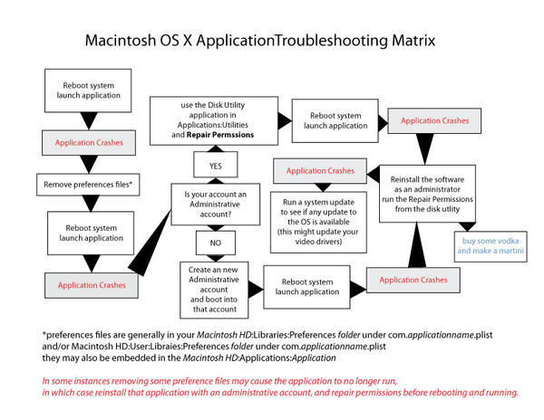

    Not to bury you with a possible flawed solution but this *might* help, I wrote this as it applies to DS but it could be for lots of other things too.
    792 x 612 - 90K
