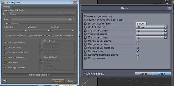

    One thing you could try to get the scale right, load V4 or Genesis into Daz Studio and export it as an OBJ file. On the screen grabs I have turned the textures off, when you get into making clothes you may want to turn those on (I said when coz in time we all try our hand at making clothing) :)

    I had this issue yesterday and decided to create a 10 foot square plane in Daz and send it to Hexagon. Once in Hexagon I created a cube that covered the square plane perfectly. This cube was aproximately 30 units. I figure 1ft in Daz is 3 units in Hexagon. Hope this is helpful.
    1 unit Hexagon = 0.33ft = 0.10058m

  • RoygeeRoygee Posts: 2,247
    1 Unit Hexagon = 1cm=0.0328084 ft.=0.393701inch.:)
    Try sending something on a round trip - create a 1m cube in Studio and send to Hex via the bridge - it comes in at 10X10X10, should actually be 100X100X100.
    Now export that from Hex as .obj, size 1 and import to Studio at 1 unit =1cm - it comes in 1 tenth of the original size. Import as custom at 1000% and it comes in at the original size.
