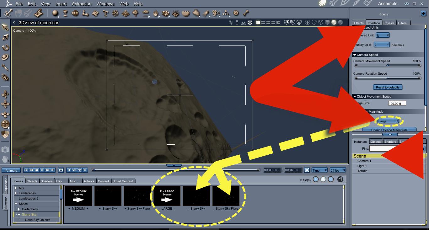

    Some things to keep in mind:
    Scene Magnitude makes a difference to which file to use!
     - If dragging into a current scene, click on "Scene" in the right panel, then go to the "Interface" tab at the top. Check to see which Magnitude the scene is.
     - If it's a Medium Magnitude, use one of the two for Medium Scenes
     - If it's a Large Magnitude, use one of the two for Large Scenes
     - Note that the two that have the words written in them are only included for organization purposes and shouldn't really be loaded.

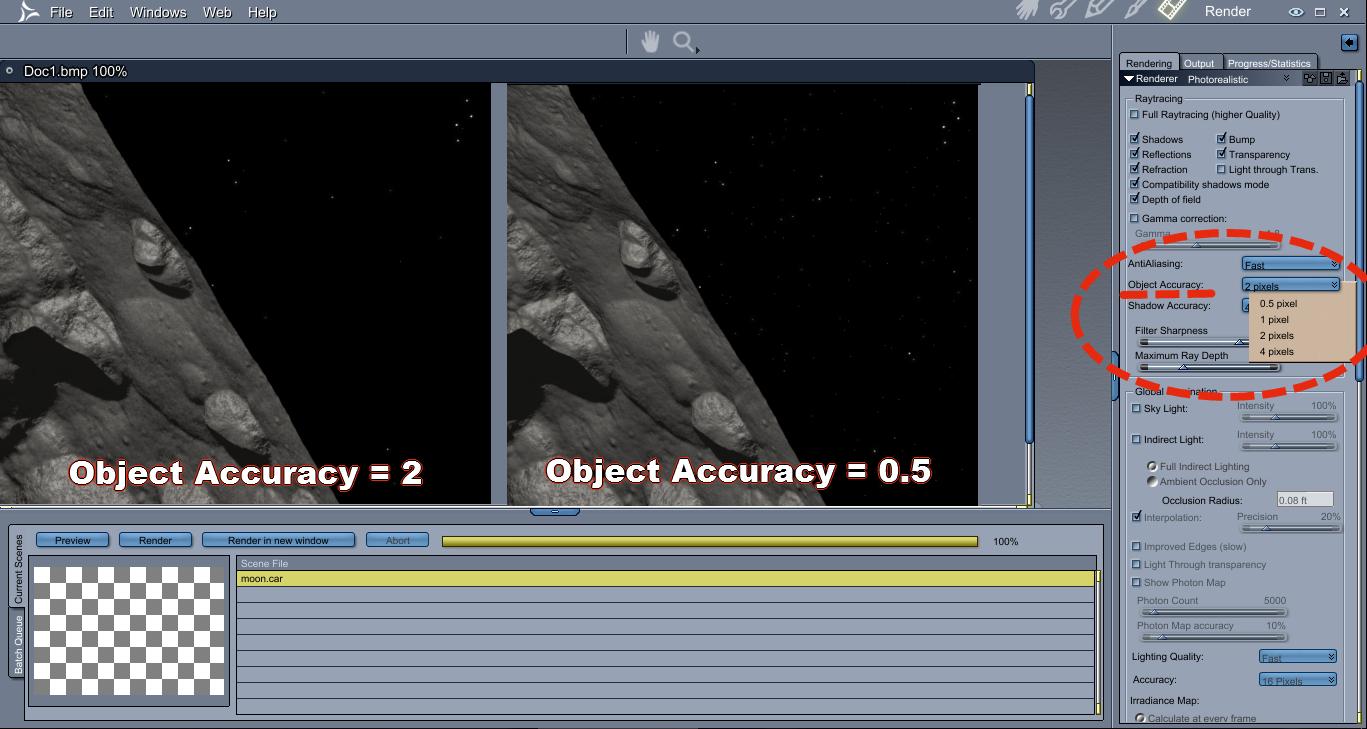

    It must also be noted that, in the Render Room, Object Accuracy will dictate how many stars are shown in the render. The lower the number, the more of the distant, tiny stars will be rendered.
    See the difference between Object Accuracy of 2 (left) and an Object Accuracy of 0.5 (right)
    1367 x 733 - 560K
    1367 x 729 - 541K

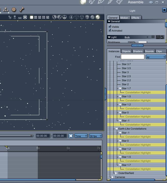

    Go into Starry Sky
    Under "Stars" > Open up both "Pattern Stars" and "Earth-Like Constellations"
    Look for the ones with a drop down arrow
    Open All of them
    "Constellation Highlight" is a bulb light that isn't needed. Select one of them, the Shift-Select the rest of them (as shown in the image) and hit Delete!
    663 x 726 - 240K
    Post edited by Dartanbeck on
