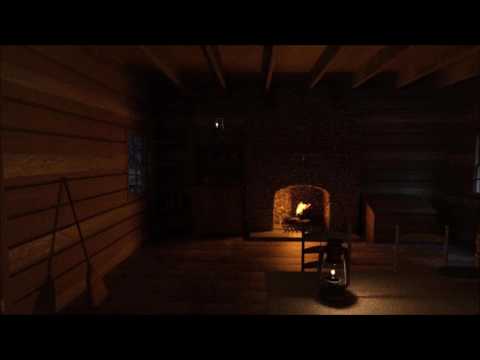

  • Carrara Octane video, needed heaps of work had to add all the maps except diffuse (as well as fixing Carrara uv wrap) manually is direct lighting only, 3Delight mats generally work ok.
    Compared to
    DAZ iray render, very slow few frames so used slomovideo to do a dreamy version
  • Oh I added fur to bed cover
  • Wow ToeJam!  So both videos are great, thanks for sharing them, but the second one was amazingly vivid!  How long did it take to render both? And you mentioned the work it took to convert the materials for the non-iray version; how long did the conversion work take?
  • well about 75 shaders, I just stuck the normal maps in bump for Octane skipped the roughness ones and added the opacity ones to the flames too.
    It was a biased as direct lighting kernel, path tracing would not have been viable for an indoor animation with emission.
    was fairly fast at about 10 secs a frame only 10 samples and took only 2 hours.
    The latter iray one was unbiased so hence the better lighting but limited to a minute per frame, still took 10 hours
  • DamanyoDamanyo Posts: 44
    Wow, thanks ToeJam!  2 hour -vs- 10 hours!  I really think it depends on the desired end product and how much time we have to achieve that.
